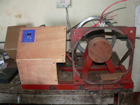

The test bench for alternators you built...
It's a wonderful thing! 5 Horsepower 3 phase motor with a variable speed controller belted to a shaft/coupler to drive alternators. I wish I had the power here to build something
so precise.  One problem was the steel framework to which the alternator
bolts.  The front magnet rotor fits right inside it with very little
clearance.  We didn't realize any problems when testing alternators with
the smaller magnets (although I expect there was a problem...) =- but
with the larger round magnets it cogged/induced eddy currents very
noticably.  So it needs to be modified so that there is no conductive
material (especially steel) in such close proximity to the magnet
rotors.  Another problem with the test stand is the belt drive.  It's
not realistic to deliver 5 horsepower at such low rpm through a single V
belt - so...  a new pulley on the motor and two V belts should solve
that problem.  I was also worried about the size of the shaft that
drives the alternator - it's 1" threaded stainless steel if I recall,
and it may need to deliver 5 horsepower at about 300-400 rpm.  After a
bit of research yesterday I think it may be not so bad as I thought, but
it's marginal at best and I do worry about fatigue especially where the
large pulley is welded to it.  A larger shaft couldn't hurt but what you
have might work forever, I have no idea :-)

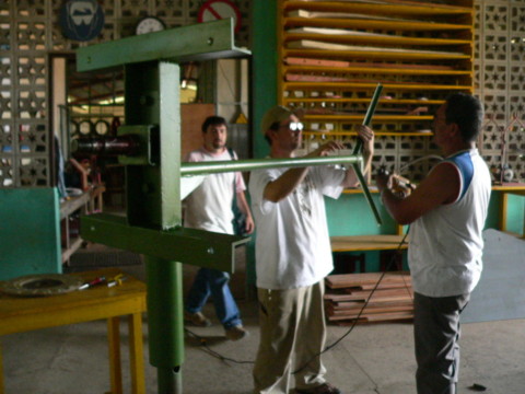

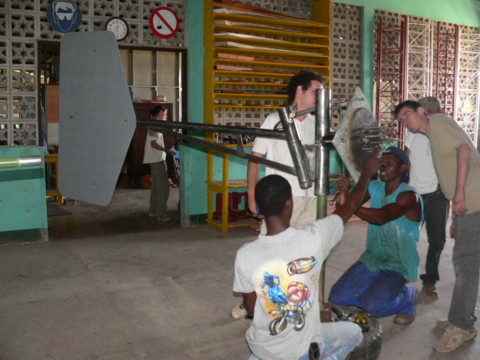

The metal frames...
So we adopted our design made mostly from pipe to the 12' machine and I
was happy with how it 'looked' and hopefully it will work/furl well.  I
don't think it's easier to manufacture than the older design (or Hughs
new design) given the tools in  your workshop, although it's probably
not 'lots' harder.  It looks neat to my eye - other than that I'm not
sure there's much advantage.  One problem is dealing with all the weird
pipe you get.  All your pipe is shed 20, thin walled stuff and even then
the sizes do not seem consistent (3" pipe in your shop seems to vary by
1/8" in diameter between different pieces).  The other problem with that
design (and in general) is... all your pipe is galvanized.  It should be
common practice to make sure that zinc is ground off in the area you're
cutting with a torch - or welding, I think this is a big safety issue,
the fumes are very toxic.  Furthermore - the welds will be of higher
quality if you grind that stuff off first.  The galvanization also
causes problems with the cutting torch... and the cuts don't come out as
well as they would if the zinc was ground off.
And again - I am worried about the tail on the machine that was built
'mostly' according to Hughes new design.  I think the tail boom he calls
for is from 48mm (2 inch) sched 40 pipe (that seems quite heavy to me
actually) and the one they fabricated there is 1.25" sched 20 pipe.
I'll stand by my bet that it falls off in 1 year :-) .
