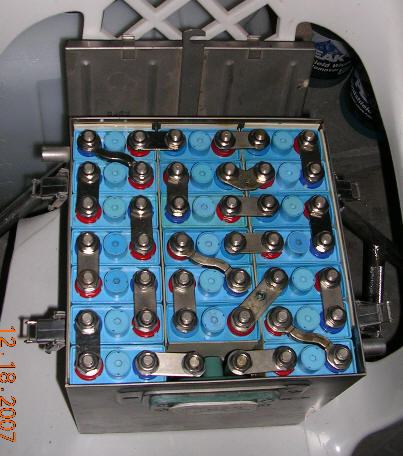

Hello everyone!
This is my first post so I hope I don't sound to ridiculous. Isn't that a rite of passage on a message board? Anyhow, I have a friend who has given me an out of spec (for the aircraft industry) Saft 4076 NiCd battery and I was going to ask everyone their opinion of it's usefulness. I should be able to obtain more of them in time. What I'm wanting to do is to power a few (maybe 4- 13 watt) CFL's in a cabin and a small TV (for football games) so I can eliminate the lighting and entertainment part of grid connection (gotta stay somewhat grid connected for A/C reasons). Everything else will be propane (water heater and fridge). I planned on connecting them as multiple 12 volt strings and charging with solar panels. Since the cabin won't be used but maybe once a month for a few days what kind of overall battery capacity would I need and how many watts of solar to keep them up during the away times? I'll attempt to attach some pictures but I'm not sure it will work.

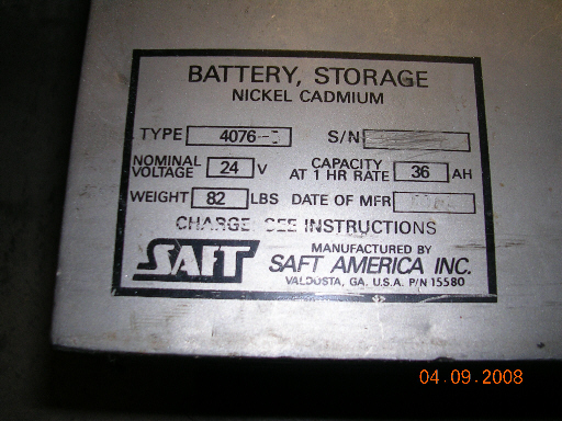

Here are some specs from the manufacturer:
Saft 4076 NiCad
 Electrical caracteristics
  Nominal voltage- 24 volts
  Nominal capacity- 36 Ah at 1 hour rate
  Power rating- (12V-15s-23°C/70°F)
  Recommended constant charging voltage- 28.5 volts
There are 20 individual 1.5v cells connected with bus bars.
Link to Battery Label
Fixed the battery picture so it displayed and linked to the photo of the label. TW

Pretty sweet deal! Since they are hooked up in series, that must mean they are 1.5 volt, 36Ah each. So...9 of them in series will give you 13.5 volts, and 36Ah. That gives you enough left over to make another string of 9 in series. Hook those two banks of 9 together in paralell, and you should get about 72Ah! That's a good start on powering the lights & TV you mentioned. If those lights and TV are 12v, it would be a big plus, otherwise you'll have to get an inverter to get 110/120v AC. Like others have mentioned on this board, a good "bang for the buck" starter set of solar panels can be had from Harbor Freight for about $200. I try to keep this board posted whenever they have their frequent sales on these panels. They're 45 watt, and even come with 2 CFL's (12v!). Just search the board for 45w, or Harbor Freight, and you'll find several topics on them.
Lucky catch!

1.)NiCds ae 1.25 standing voltage not the normal 1.5 like Alkalines and Lead-Acid.
So the best thing to do would be like rualmcguyver said, link up 10 of the 20 in series then hook the 2 sets up in parallel.
This will give you a full 72Ahr of usage.
  1. )NiCds, wet or dry can withstand a deeper drain on them than Lead-Acid, so that's also a plus!
  2. ) NiCds are current lovers and need to be charged using a constant current instead of constant voltage like most chargers will do.
  3. ) they'll need to be charged in values of 10, i.e. C/10 is a good value to charge them. C=the total amerage of a string so at 36Ah you'll not want to charge these at more than 3.6Ah for the total string C/20 is better.
  4. ) NiCds like Lead-Acid need to be able to vent, for the same reason, i.e. pressure build up. The lid I see in the back ground is metal and probably okay for previous use, but a plastic one with a bit more room would be better.
The HF PV is a good starter unit, the newer one much better than the old one.
It's max out put is 45 watts on a good day, which is way low for charging this pack fully.
you could have a pack of more than 900 watts total the HF puts out 45 watts total.
That's about 20% which would be okay for mantaining them but possibly not for a good deep charge. Since you're going to be using these once in a while it might be okay, larger unit would better, along with a NiCd specific charger.
There's a ton of charger circuits on the web if you want to build one, even ones specific for solar use.
IF you have a little more money to spend, it would be good to get a real solar controller than the one that comes with the HF set, I did.
I know this is long ;
Hope it helps
