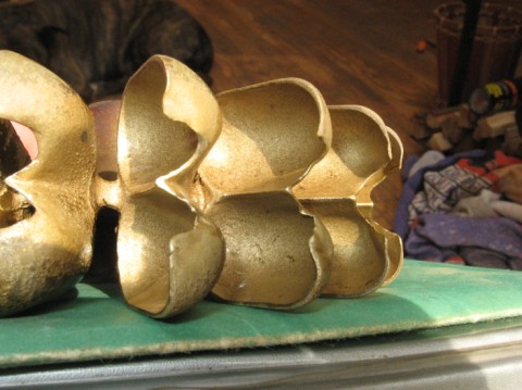

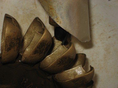

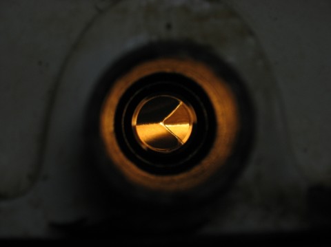

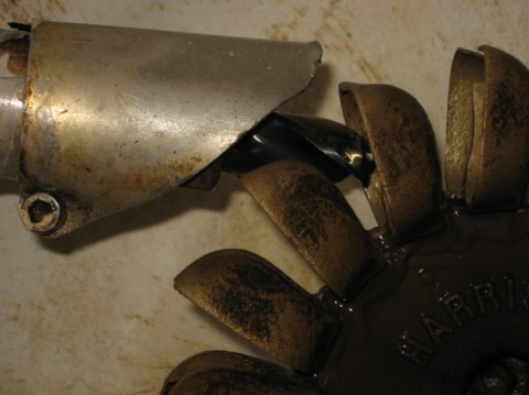

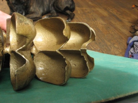

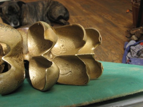

by Jonesy on Mon Apr 14th, 2008 at 04:01:19 PM MST
Here are some shots of the nozzle alignment.  I sighted down the nozzles as in the third pic, but looks like I could improve a bit with the drill bit.
Here is the damage to the runner.  Some slight pitting on the inner surfaces of the buckets in addition to the dinged up edges.

Re: Problems with Preexisting Hydro (3.00 / 0) (#12)
by dbcollen on Mon Apr 14th, 2008 at 05:32:09 PM MST
There is significant wear to the cups, but still servicable, aiming looks good, maybe slightly to the inside. you need to get a new rheostat, and hook up your ammeter inline, open all 4 nozzles, and dial the field for maximum amperage out of the turbine.  If you have a junkyard around you may try several different stators, they come in many ratings from 37 amps to 100+ all are wound differently, and you may find one that works better. I have rewoung many of them for my permanent magnet conversions I used to do. I build high voltage inductive alternators and a step down transformer array to drop the voltage at the batteries. I can build you one if you like.
