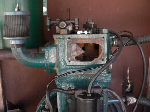

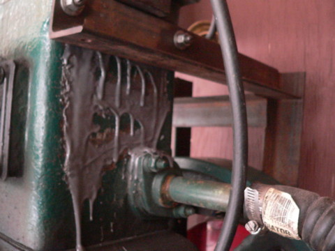

Ouch.  This stroke of bad luck started on Friday.  Friday morning my wind turbine started making strange loud chirping sounds...  (I thought it was a bird at first) - then it changed to chirping/loud thumping.  Then it locked up in light winds.  I figured the bearing failed.  So we ran the listeroid diesel all day - I forgot to drain the water tank Friday night though.

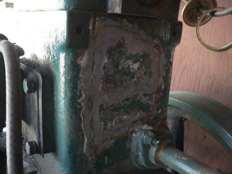

The side was even worse than the cylinder head - I broke out the pieces,  flattened them, ground them down and tried to glue it back together with JB weld.  I think it was old glue...  it wasn't adhering very well so I scraped it all back off.  The hole is about 4" wide/6" tall.
Got some new JB Weld on Monday and gave it another shot.

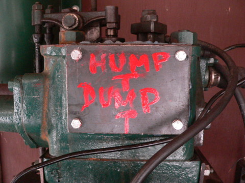

I covered the hole in the head with a steel plate/gasket.
Put new glue on the side, it worked out better this time (kind of ugly though).  I ran it for a couple hours yesterday - so far so good, it's still water tight anyhow.  Ill never dare to pressurize this engine though.
Also - I turned my wind turbine back on Sunday evening (out of desperation  - I needed the power).  It broke loose in a good gust, make strange noises for about 1 min and then took off, it's been fine ever since.  It evidently chewed up and spit out whatever the problem was...

Dan you'll never get me to live in a land where an engine that has been running all day can get that frost damaged in one night.
We haven't had that sort of frost for a few years and I like it that way.
Time will tell with the wind turbine, it may be something silly and not cause any more bother, but it does have some symptoms of a cage breaking up in a bearing.
Good luck anyway.

Dan, with the Spring and Winter conditions we have been getting this year, I would  keep the tank drained until needed or put in Antifreeze.

When I was young I was taught of a product called 'anti-freeze'. The fear if it was not used in engines, severe damage was possible with freezing temperatures was firmly installed in my feeble mind. I use the product and have never had to repair such damage on items when I was in charge of their care.

Ron, it should be setup better.  As it is the cooling tank is too small, I can use antireez  but it boils off quickly.  (JB weld is actually cheaper)
Hopefully soon, that small cooling tank will be gone and well have some nice radiators.

In addition to lowering the freezing point, making the eventual ice slushier, and otherwise modifying the low-temperature expansion chacacteristics, antifreeze does two other things for cooling systems:
 - It raises the boiling point, allowing the engine to run hotter without boiling over.
 - It has additives that inhibit corrosion of the metals in the water jacket.  (This lengthens engine life, improves heat transfer, reduces blockage of cooling water passages and jamming of thermostats by rust flakes, and the like.)
You should use antifreeze even in the summer and even if you're not pressurized.  You should also change it every couple years to renew the corrosion inhibitors (and flush out any corrosion and debris that occurred regardless).
They now call it "antifreeze and summer coolant", in an attempt to keep car owners in mild climates from refilling with water (especially in the summer), skipping cooling system service, and the like - eventually destroying their engines as a result.

Damn that was a messed up week, Seems like you did well under the circumstances. JB Weld ain't pretty but it works in a pinch. Many years ago I used it to fix a leak in a commercial boiler. Yikes I know, but as far as I know it is still holding. We gotta do what we gotta do.  The key is how quickly us fixers can come up with a workable solution and get back to what ever we were doing.

Automotive engine blocks have freeze plugs for a reason.  If the engine coolant freezes, it pops out the plugs instead of cracking the block.
You might want to drill a hole in the side of the cover plate you made and install a freeze plug.  If you forget to drain the water again, you'll only need to reinstall another freeze plug.
I've even seen reusable freeze plugs too.  The ones with the thick rubber between two steel washers.  Tighten the bolt going through it, and it squeezes out the rubber to fit the hole.

They are for some reason called "Freeze Plugs" while in fact they are the holes needed to remove the sand left inside the block from the casting mold. "freeze plugs" will not save an engine block from cracking when they freeze.

That's part of what antifreeze is about:  When the solution finally does freeze and expand it at first forms a slush that is flexible enough that it will often push out the freeze plug rather than crack the block or head.  (Pure water, of course, will form a hard ice block that doesn't flex well enough to avoid cracking the castings.)

     Tough week indeed.  Have done the water thing myself,  more than
I want to admit.  The J.B. weld will work, as you have already seen,
But if you want to do a more permanent repair, let me suggest Ni-Rod.
     This is a high Nickel rod that can be used for repair on cast iron.
     The big advantage is that Nickel is very flexible. Nickel is almost like Gold in flexibility.  Have repaired many exhaust manifolds with
this rod.  Have to hold a fairly long arc though.  Maybe your repairs are
enough.  Good Luck.  And Thanks.
thanks all bj
Re: Tough week for electricity (3.00 / 0) (#20)
by Warrior on Wed May 7th, 2008 at 05:11:50 AM MST
Yup, as BJ said you could try to arc weld them with 99% pure Nickel rods. It's very tricky to weld some types of cast iron.
Usually the low grade stuff made from scrap metal is almost impossible. After you've laid out the bead, the cast iron cracks due to thermal expansion/contraction.
Some parts need to be pre-heated before welding and allowed to cool slowly.
Definitely not an every day job.
Maybe the JB Weld will hold for a long time...
