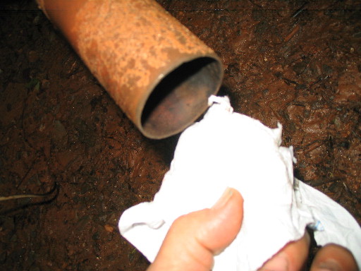

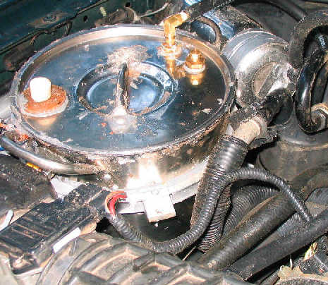

After 900 miles the anode is spent but the milage increased
Ok  returning from what ended up to be 730 miles round trip with a total usage 32 .917 gal of fuel and between 3 and 4 quarts of water .totals mileage 22.17 mpg average over the total miles this is and improvement of 5 mpg over the average 17 mpg I was getting with gas alone( the epa figures for a 4 L ford v6 is 14 to 18 ) .You can see from the pics the anode oxidized big time  . The voltage was between 12 and 15 volts the current at start was 15 to 20 amps and dropped to 8 and 13 at the end of the trip ( probably given th the oxidation of the anode). The stainless  even though not attracted to a magnet did oxidize with the high concentration of oxygen and heat . The millage figures is good news though and the moderate induction of browns gas to an unmodified engine does work with the oxygen sensor in this model .The  engine was taking all the cell could make and I feel sure that if I could have had more volume the mpg would have been better . I connected the tube to the to the crank case vent tube and moved the crankcase vent to the filter housing there is a slight vacume at that point . Here's a few pictures of the cell when I took it apart (Admin I took the AVI s down as promised Thanks ).
 The log started in Cartersville GA where we topped of the tank  -to Rome GA on us 411 _ On 411 to Gadsden AL  we picked up431  to Huntville AL on  Then west on 560 in Huntsville to I 65  south to  Cullman  AL  us 69 to us 78 - us 78 to Tupelo MS.
Where we topped off the tank total 16 .001gal . The trip back was from Tupelo back down 78 to us 13 on us 13 to us 43 to Tucaloosa AL around town there and stayed the night we then took I 20 to Brmingham then east on 20 to Atlanta GA  we hit 285 in Atlanta at 6:30 north on 285 ( no traffic)to Chamblee GA
I dropped off my help and headed back west on 285 to I75  north to 575 then north on 575 to Holly Springs Ga where I filled up 16 .917 gal the Microsoft streets and trips milage agreeded with My odometer read ing within 8 miles ( drove aroung Tuscoloosa a bit ).I'm working on a Google earth to confirm.
One of the pictures is a swab of the inside of the tailpipe with a paper towel no carbon black where  I notice a bit form before the hho induction.

 Very interesting results! Nice experiment, I'd love to see you take it further.
 More details on the build would be worthwhile to some people not familiar with all this.
 Maybe a new cell using more electrodes would improve efficiency? I see you are noting high heat which is a loss in the conversion process.
 Also isn't this putting some strain on your charging system? Have you noted any lower battery voltages after a trip?
 Keep up the good work, most of these brown's gas systems I've sen do very little if anything to improve overall fuel efficiency. It looks like you hit a sweet spot.

"I connected the tube to the to the crank case vent tube and moved the crankcase vent to the filter housing..." Is this where the PCV valve is connected?
The reddish coloring, which some folks call anode mud can be minimized by using neutral plates between the cathode and anode. I bench tested my unit this weekend and I see some of the same stuff. I'm thinking its the iron in the metal that gives it this color.
What type of drier are you using?
Re: 8 qt cel and milage results (3.00 / 0) (#20)
by tecker on Tue May 13th, 2008 at 05:45:20 AM MST
Yes that'S the pvc from the oil fill port on top there's goods vacume there at 1000 plus rpm   I moved the check valve ( a break booster checkvalve $5 buck at Advance)
 to a 2 1/2 cylinder stainless container . here's apic alittle jacked up but i'm gona cut it down

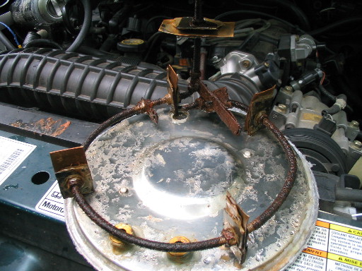

It was rust alright the oxidation of the anode started after 100 miles I decided to weight on some teflon washers for insulator for the gougeing rods and am needing to travel alittle more this week so I went to welding supply and got a couple of pounds of 316 tig rods used one rod and brought it out the side for positive connection .Up and running making a little trip today the gas production is very good volume.Back on the road . Idle  good and acceleration good ,hill climbing seems much better than before .I'll get back to the gouging rods when the teflon washers get here here's an ebay link to Rubber man .http://stores.ebay.com/RuBBeR-HoUsE
Re: 8 qt cel and milage results (3.00 / 0) (#23)
by tecker on Wed May 14th, 2008 at 06:05:13 AM MST
An update ; the 316 stainless rod started rusting right away and the Gouging rods are too britle to use in a vehical so I 'm tring # 6 bare copper and ordered some 1/8 titianium rods .

Quote: An update ; the 316 stainless rod started rusting right away.
Are you sure your seeing Rust and not the coating the will forum on the rods.
Now much current is it pulling ?
