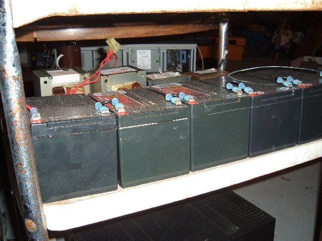

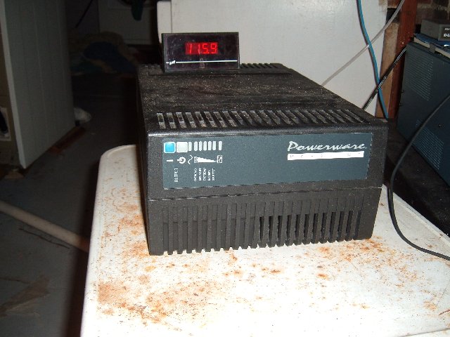

I have this nice business grade powerware UPS. A ham at our hamfest last year gave it to me because he didn't want to haul it home.
It's a Powerware 9000 series 700W full time UPS with sine wave output. It will cold start with no AC line applied. It uses (5) 12V 5Ah in series for 60VDC. When I got it, the batteries were toast. I bought a new set of 12V 5Ah batteries to put in it. It came with an external battery box that had already been stripped of it's batteries. Being an online UPS and cold starting, it has a good use of being a backup power source for the wife's O2 concentrator.
These batteries are all from motorized wheelchairs. There is a place in town that sells and works on scooters and wheelchairs. Most of them were pretty sulphated when I got them. Now this UPS charges it's batteries with a ringing waveform that effectively desulphated these 5 wheelchair batteries.
I just bought a bunch of HF solar panels, and am thinking that I could series 5 of them and charge these batteries via solar power. The internal charger has it's own fuse, so could be disabled. Of course the panels are 15 watts apeice, so the string would be 75 watts total. I've looked all over the net, and while I can find plenty of charge controllers for all voltages up to 48V, there seems to be no small charge controllers that will work up to 60VDC nominal.
It will keep the wife's O2 concentrator up for 30-45 minutes. Gives me time to set up the generator. If I could solar power the batteries, maybe I could use it for some other loads. Anyone got any ideas for controlling the solar power input to this?

Wouldn't 5 batteries in series need to have 72 volts for charging ?

Picture clearly shows 5 batteries in series.  It is just not that hard to boost voltage up to 60-72 volts from any 24V or higher source.  Especially  when AH batteries would limit the current to less than an amp.  No need to worry about code when wiring is internal to cabinet.  I'd take it in a heartbeat.

I have the same brand but mine supplies 15A at 120vac. I run mine from external batteries from an old apc battery pack. These units have a molex style connector at the back for external battery packs.

Those batteries that are sitting on the shelf below the unit are external batteries. They are 12Ah batteries from wheelchairs. They were too big to fit inside the external battery case. There are also (5) 5Ah batteries inside the unit shown in the first picture.
Opera;
I am curious how I may boost 48 volts easily to this level. I probably would have to chop the 48 volts, transform it up to what I need, and rectify it. Right? Most of the invertors that people use do this to bring the incoming DC up to a level that will make the peak value of the output waveform.
As said by someone earlier, it is probably not worth messing with this UPS to make it generally useful in a RE system. I will probably keep it like it is, as a backup power supply to keep wifey's O2 concentrator running long enough for me to get generator running. I have other MSW inverters that I use commonly for other things.
