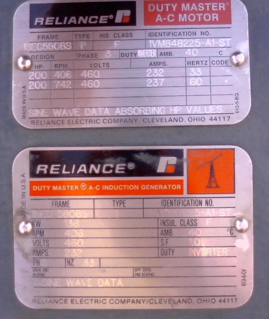

Would this work for a home gen standby :D
Really, anybody know anything about this thing?
Thanks,
Red

What do you want to do with it?
Just a 3 phase induction motor, obviously intended for a vf drive. Presumably 8 pole with fairly high slip.
Do you propose to convert it to pmg at enormous cost and effort or are you hoping to self excite it as an induction generator. In which case you will need a lot of expensive capacitors and the results may be questionable. High pole number motors make poor self excited generators.
Chinese alternators are so cheap that this would be a questionable proposition for anyone not looking for a project.
In general motors are best used as such and if you want a generator buy one especially at such large sizes.

It seems like this thing can be used both as a motor and as a generator.
Re: Would this work? (3.00 / 0) (#5)
by Flux on Wed May 14th, 2008 at 12:14:50 AM MST
Yes looking at the second plate it implies that it may have been used as a grid tie generator.
Any induction motor will generate if driven above sync speed when connected to the grid.
For a stand alone generator you need to supply the magnetising current by capacitors and it is a less stable situation.
If the speed rating is as a generator then it may be 10 pole, you would need to do a bit of investigating to be sure. Not sure why the motor and generator plates have the same speed.
Build yourself a 130kW wind turbine and grid tie it.

BTW - the yard guy said it probably weighs in 3000+lbs and I can get it for $0.50/lb.  But somebody has put a deposit on it before I did.  Waiting...
Not sure if this is gen for me :D
Michigan only allows you to sell back 30kw max (I think), so it might be a little overkill.

 I can't imagine trying to put that thing up on a tower!!  The cost of building a tower for that would be a bit much for a DIY project. It would be great for a DIY Hydro project though!!
