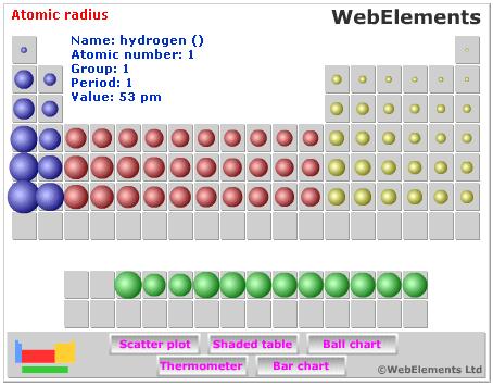

Re: Norway island stores wind power for still days (3.00 / 0) (#14)
by Sundog on Wed May 14th, 2008 at 12:02:20 PM MST
Hydrogen is bugger-all hard to store.
The molecule is itty-bitty, and tends to leak through "solid" materials such as steel and aluminum like water through cheesecloth.   Brown's Gas is viciously nasty stuff.  Very energetic, burns very fast, and burns very hot!   Don't even imagine playing with it unless you want your only remaining body hair to be on your nether regions!
One of the first applications of Oxyhydrogen (the real name for Brown's gas) was lighting by heating a chunk of chalk or lime to incandescence. That's where "limelight" comes from.  Another was a torch that was used to melt "exotic" metals (platinum, titanium, etc) before the advent of arc furnaces and induction heating.
Producing oxyhydrogen in a closed, pressurized container is simply begging for an explosion to level your workshop.  I've worked with it exactly 3 times.  The first time it self-ignited due to static electricity.  Thankfully, it wasn't under much pressure and simply made a small torch that singed my workbench and scared the poo out of me.

Re: Norway island stores wind power for still days (3.00 / 0) (#23)
by MattM on Fri Jun 13th, 2008 at 08:58:21 PM MST
Hydrogen is relatively tiny.
This picture from http://www.webelements.com/hydrogen/atom_sizes.html
Hydrogen is in the top left corner.
Re: Norway island stores wind power for still days (3.00 / 0) (#25)
by electrondady1 on Sat Jun 14th, 2008 at 07:11:54 AM MST
i wonder if coating the inside of the steel tanks with an epoxy paint might slow down the penetration of hydrogen.

Re: Norway island stores wind power for still days (3.00 / 0) (#29)
by joestue on Sat Jun 14th, 2008 at 12:42:10 PM MST
not significantly.
