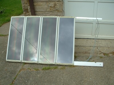

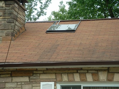

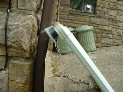

I mounted mine to the roof with angle iron bolted at the peak. Then added aluminum C channel between the iron to support the 3 panels and lock them in. About an inch or more airspace under them. This is the southwest facing roof.
These are the next set to go up on a dormer facing almost due south.
They will be hinged at the top to allow for seasonal changes. All aluminum on these and still working on the mounting hardware. These will have about 3 inches clearance.
Also left room for my BP 50w that will be brought in from the farm if it gets sold.
Top with spacers. These are ICP Battery Savers with mounting holes.

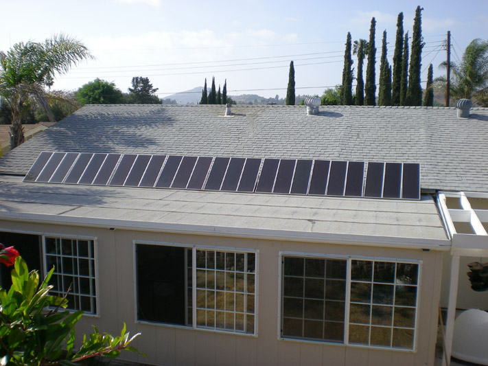

Here's my 8 sets of HF panels (360 watts):
I didn't want to screw them directly into the roof (worried about causing a leak).  I ended up tying them down with thick rope, the rope is pinned to the back with an alumnium bracket which is screwed into the side of the wood roof.  They are plenty sturdy so that they wont budge during heavy winds which is all I worried about.
Last year before I tied them down, I woke up on a VERY windy night and found them inches away from getting blown off the roof... couldn't believe it!
