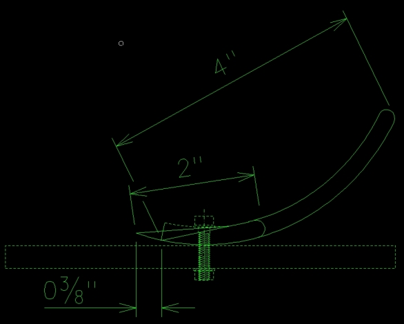

I just finished carving my 24" blades to go on my Ametek motor.  I used schdule 40 6" pvc.  They are 4" at the root and 2" at the tip.  They look pretty sweet.  They each weigh exactly 7 ounces.  Is this too heavy?  I can easily take some more off if need be.  Thank you.

With 6" pipe, and a 4" root, something must be pointed the wrong way.
Part of the blade is fighting another part of the blade.
The 2" tip has me wondering too.
Maybe I am wrong, but weight seems to be the least of the problems.

Ghurd, It sounded about right to me so I layed it out real quick and it looks
pretty good- especially if the trailing edge got raked back at the tip like I've
shown in the drawing
Re: Blade weight (3.00 / 0) (#8)
by ghurd on Fri May 9th, 2008 at 07:02:56 AM MST
Looks a lot better than it sounded.

That picture is very helpful.  It is almost spot on.  Except for the 3/8" off set between the tip and root.  I can see you did this for more twist.  I did not do this, I ran my leading edge line parellel with the tube, but I still have nice twist, just not as much as that.  I was able to get a nice foil, and then sanded it flat out the end.  I will post a picture if I can figure out how.
