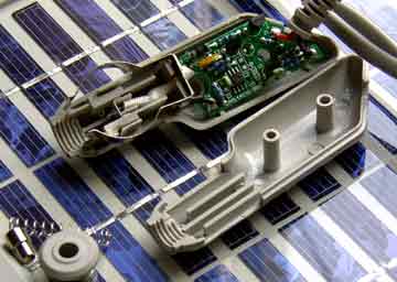

by ghurd on Fri Jun 20, 2008 at 09:43:42 AM MST
Here you can see the pieces, wire ribbon, and a bit of the 'blue cracked ice' look of multi crystalline panel.
http://www.otherpower.com/images/scimages/2050/VWPVCntrlr.jpg
Ghurd.info
