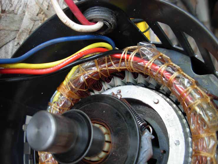

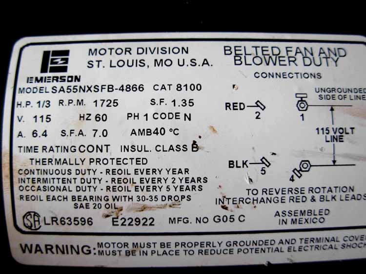

I picked this up today for 15 bucks.  It runs good but I am not getting alot of movement on the needle with my fingers spinning it.  Also, when shorting the wires there does not seem to be any slowing.  Should the blue and black wires be wired together and the yellow and red? How exactly should the wires be?  It does not seem to make any difference what combination I use it makes the same amount of movement on the need of my mulitmeter.  Sorry for the stupid questions but Im still learning.  Thank you.

Do you want to know why it's not making power?If so it's a induction motor and would need 4pls of mags on the rotor or a special recipe at high rpms.
 Not a good choice in mt opinion.

Hi.I think you have learned a $15.00 lesson already. I, of course,  have done the same thing you are doing now.
And then the people on the board told me to do my homework and read more,which I am still doing.I can't tell you a whole lot about motors but you have to turn down the armature,add permanent magnets,maybe ,rewire the coils.if it's got bushings you have to add bearings..in your case, it may be best to buy a permanent magnet motor and start from there, maybe.Anyway, You are hooked now...no turning back! Good luck!

I don't think it's so bad.
Remove the extra motor related stuff ("Thermally Protected" and that spring do-hicky), split the wires (maybe the yellow wire goes to 2 wires), make room on the rotor for 4 magnets (or magnet poles), add magnets, and it'll work.
I do not mean to imply it is great.  I mean it isn't too hard to make something that works.  I am happy if it works well for the time and cost (hobby) until the next one replaces it.
Master Zubbly (RIP) would only use 3 phase motors for a serious project that did not require rewiring.
Got it?  Try it.
Worst case it learn a lot for something better.
Two cents.
