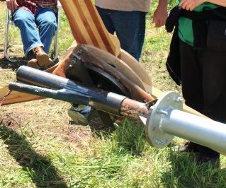

   first the flange fitted in the pic here.
   is that standard for your mills.
   its looks interesting  the top fitting has gussets welded on and looks like i might try the same thing.
   second i see there is six lug studs and nuts.
  it looks like it works out well for two studs each blade.
   four and five studs  not so good as the six.
    on the bigger mills its just right.
   so thanks to you guys and all who was involved in the making of this great post.

Hi - normally if we use large pipe then the tower stub is similar, but - we don't normally bolt them on like that.  We had to make a stub that would fit the same flange that works with the SW windpower Skystream turbine.
