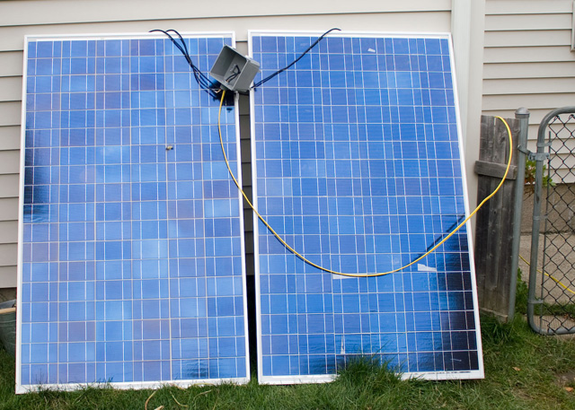

I just received two of the 180 watt panels, a fx-80 charge controller and a 200 amp t-fuse and holder last week from Sun. The cost was $540 for each of the panels and $575 for the charge controller. I wanted the mx-60 but they were out of stock. Shipping for everything to western new york was $180 (panels by freight - everything else fed-ex.
Of the two panels I got one looks like new. The other has some areas where it looks like the front glass is a little away from the solar cell. This does not seem to effect the panel at all. I have added a picture of my test wiring (using 12 ga romex :) - will be using 2 gauge this week) so you could see the blemishes.
(note : in the left one that blob is a bee not a defect - that one looks perfect. All the blemishes are on the right one)
I wanted the higher end charge controller so I could get these grid tied type panels which were cheaper then the alternative. My plan is next year to add four more panels wired in two sets of three ( for about 75 volts at 15 amps )
Right now I have them wired in series and generate around 50 volts @ around 6 amps into the charge controller that way. I then have them wired into a 12v battery bank.
