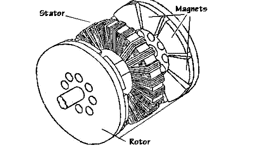

I've been pondering axial flux wind turbines for a couple years now and I have some ideas now that I have a place to erect.  I'm planning a 48v 10 footer like otherpowers but i want to experiment with torro windings(even though it looks like lots of work) and 1/2" cubes with 26 lift lbs. I'm looking to stick with the 12" rotor but have a like 38 1/2" cubes in a row each. I think thats overkill but I can allways open up the air gap if needed besides their like 60 cents. My stator should end up 7/16 axial x 5/8 thick.  The recipe calls for one #17 x 140 turns x three coils per phase = 9 coils.   As I understand it that should give me the same volts but with a huge amp drop as my coils will average 1.5 in or so vrs 8"ish. So it would appear I would need to add alot more coils in parrallel to each phase.  Just not sure how many  I can always expand to 13" rotors or add more row(plenty of room lol) to stay within my optimum stator dimensions.  So my questions are how many more coils should I add(as many as it takes to get to 6 lbs), and hows increasing magnetic poles and rotor speed by increasing circumferance factor in? I read some studies that axial flux with high pole counts are more effecient than radial flux.

if you are trying to build a 3 phase alternator
the pole count must be divisible by both 3 and 4
your rotor is big enough to carry 38 1/2" poles and have a similar mag spacing.
but it won't work out evenly.
you would need to reduce your pole count to 36 and build 27 coils.
as well, you will need to do a test coil(s) to learn the number of turns and wire gauge
that will provide you with your desired cut in speed .

Re: Newbie plans with custom stator hopes 4 700w (3.00 / 0) (#7)
by MAXial dreamer (ihearbs@yahoo.com) on Wed Jul 16th, 2008 at 07:29:38 AM MST
you kinda did it is still a axial machine it just has different winding method
the article even suggests opposing poles to be selected. N vrs N S vrs S instead of NS SN
This would not require jacking rotors.
http://www.motordesignsolutions.com/pdf/iemdc03_ronghai.pdf
see pg2 fig.3 +4

Re: Newbie plans with custom stator hopes 4 700w (3.00 / 0) (#8)
by TomW on Wed Jul 16th, 2008 at 08:02:44 AM MST
Uh, have you tried to actually wind a toroid as a test?
Not a trivial undertaking, especially compared to a coil winder as used by most here.
I cannot help but see this .PDF as anything more than another academic tossing theory at a "problem" that does not actually exist. Yet another example of what I tend to think of as "over thinking the plumbing".
Looks pretty involved to gain "something". Someone[s] suggested this long long ago but it never got built that I recall so, perhaps, there are some non trivial "gotchas" to do it. Maybe in a factory manufacturing process it could be useful but so many miss the fact that construction techniques for industry do not cross over to the DIY garage builders this site is focused on.
Anyway, good luck and keep us posted when [not if] you build it.
Re: Newbie plans with custom stator hopes 4 700w (3.00 / 0) (#11)
by MAXial dreamer (ihearbs@yahoo.com) on Wed Jul 16th, 2008 at 08:45:18 AM MST
The purpose of the article was to conpare the drum (radial) vrs the plate (axial) machines but drawing 2 and 3 are basic machine I have in mind.

Re: Newbie plans 10' with (3.00 / 0) (#13)
by Flux on Wed Jul 16th, 2008 at 09:07:24 AM MST
I also thought it was 4700W, this modern language is difficult to follow.
Yes I am sure you can do it as a Torus in about 4 forms, some with teeth and some without. It will be hard work and at best you may save 30% on magnets but those little tiny cubes are not going to make life very easy. Pull in Lbs is meaningless so that doesn't give us much of a clue.
Using a Torus you shouldn't be using the common 12/9 dual rotor as a guide, that is not the way to do it. There is nothing magic about the 12 0r 13" disc diameter either so I wouldn't limit yourself by that.
I think a well designed torus should work quite well, but the actual performance will be no different from simpler constructions and unless you do something with the matching of the load the efficiency will be the same.
Don't thank any of us for help, nothing posted here is going to be much help to you and you will have to start from scratch rather than try to adapt windings for a different type of machine.
Good luck and keep us posted.

Re: Newbie plans 10' with (3.00 / 0) (#15)
by Flux on Thu Jul 17th, 2008 at 01:25:20 AM MST
I can't easily check any figures for a torus but with 32 of those cube magnets per disc ( 64 total) you are way below what is needed for a 10ft rotor using an ironless machine.
Even with the torus I don't think you will be even near to handling a 10ft prop.
You can't settle a winding without deciding a speed so you have a chicken and egg situation. If you build the alternator for 10ft and miss then it will be too slow to fit smaller blades.
I am inclined to think you would probably match an 8ft machine reasonably well.
The core will cost you much more than sensible magnets but it will be interesting.
