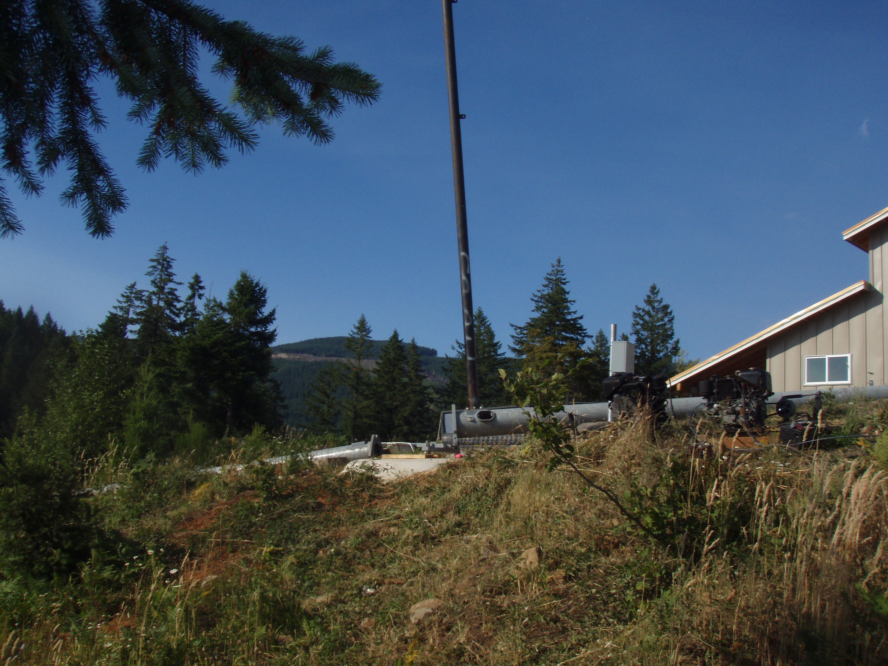

I am installing a turbine on a hill.  I will be using 4 guy wires.  Unfortunately my guy wires will all be at different elevations.  The two guy wires on the sides that support the pole while raising and lowering are about six feet in elevation different.
any suggestions on what I should do?

The tower is a tilt up tower.
The tower is 45 feet tall
The radius of the guy wires is 30 feet
the top guy wire is attached to the tower at 36 feet
The two side anchors that support the tower as it is raised and lowered are at different elevations.
The first of the two side anchors at 30 feet away is 1-2 feet in elevation higher than the tower base
The second of the two side anchors at 30 feet away from tower is 7-8 feet lower than the tower base
The tower tilts up hill slightly, that anchor point is 1-2 feet higher than the tower base
the gin pole side anchor is 7-8 lower than the tower base at 30 feet.
Any suggestions on how I can tilt the tower down without the elevation change causing problems?
None of the anchor points have been set in concrete.  However the tower base has been set in concrete.

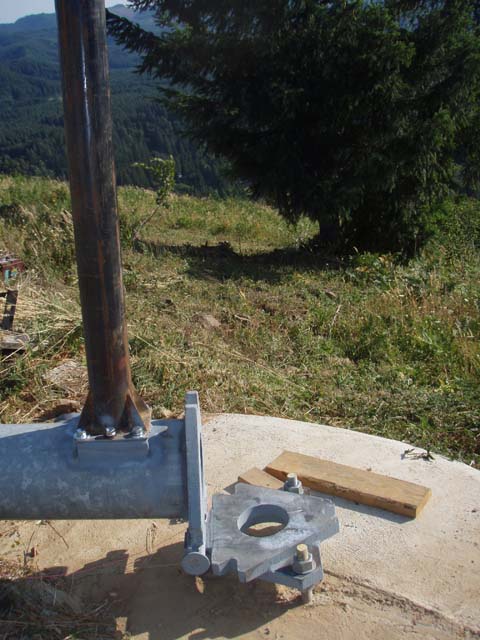

I also wanted to say that your hinged base looks fantastic.  Are those city lamppost or overpass signpost standards?  Apart from being heavy, the tower is probably very rigid.
Steven Fahey
Re: guy wire elevation (3.00 / 0) (#8)
by oregon wind on Thu Jul 24th, 2008 at 07:28:06 PM MST
Hey Steven:
Thanks for the hinge compliment!  This is a 45' street lamp tower.  I managed to purchase two of them.  They are quite stout, and have a base that was nicely adaptable to hinging.

I can dig out part of the hill that is too high and that is my plan.
I will be installing cement anchors.  I had some custom auger anchors made that are 6 feet long with two ten inch augers on them.  Unfortunately, I went to install them and hit rock, my tractor twisted the top off a 7/8" diameter auger.
The tower is 75 feet from my house and barn
I will be installing a 13' wind mill, but I am building this tower to hold something larger should I ever decide to install one.
I will also be installing a second wind mill with the same problems with elevation shortly after this one, so that I may test different windmills in the same wind.
I think my solution will be as follows . . .
I have figured the angle of the cable coming off of the tower down to the ground.  I will drill 30" diameter holes 5' deep at the point in the ground that the cable would hit using the angle from the top of the tower.  (The cable down hill will be much longer).  I will then install a steel pole (probably 4-6" diameter) set in concrete, at the 30' radius that is high enough to meet the elevation of the bottom of the tower.  I will either have a large eye on the top of this pole and send the cable through it, or I will attach the tower to the eye, then from the eye to the anchor in the ground.
The eye on the top of the tower will act as the pivot point for the long cable, making it so that it doesn't get loose when lowering the tower.
I hope I explained this well enough to understand.
Let me know if you agree, and thanks for your time.
