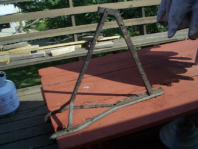

I was thinking maybe something like this could be made to adjust for seasonal adjustments!
In the pictue is a ladder jack that roofers use to support scafeling or walk boards between 2 wooden rung ladders, it adjusts to make the walk board level while the ladder is at a diferent angle.
Re: Chart for Seasonal Solar Panel Adjustment (3.00 / 0) (#13)
by wooferhound on Mon Jul 21, 2008 at 06:52:16 PM MST
Thank You,  thank you . . .
This is the solution that I have been looking for. I have been thinking of hinged standoffs kinda thing. but this is exactly the solution that I have been looking for. I have been thinking about this problem for 2 months.

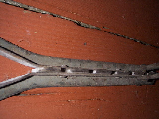

by mixerman on Fri Aug 29, 2008 at 06:25:23 AM MST
Here is a follow up picture , show how different degree slots are sandwitched between angle iron. Its all been rivited together.
