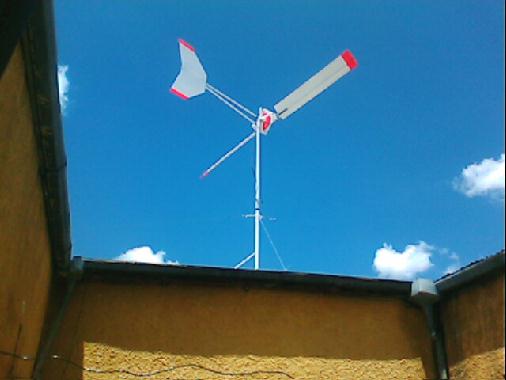

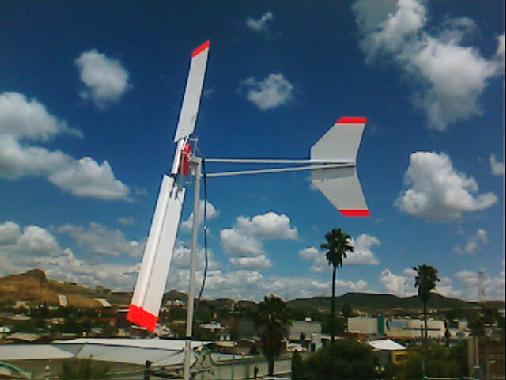

First Genny,....up and running
By rpcancun, Section Wind
Posted on Fri Jul 25th, 2008 at 05:36:38 PM MST
Well it's finally up, not much wind to test though,.. after 100' plus of 12 gauge wire from tower to shop there was a good voltage drop,.. I was reading 6-8v in low wind after rectifier, but it does turn very slow, blades are for test puposes only and are on pith control and they are 1 foot wide by 6 foot long, with the pitch hub its around 14,foot diameter
Rotors are 14" 1/2 steel 12 2x2x1/2 mags per disk, coils are 16g 180 turns.
(9) coils,...if i where to go 16g two in hand would that mean to get the same volts it would be half the turns (90)?
Thx
Rob

no for the same volts you would need the same number of turns,but that would make the coils twice as thick.I would first look at the blades they look to wide at the tips and to much angle for any speed.
Re: First Genny,....up and running (3.00 / 0) (#2)
by Flux on Fri Jul 25th, 2008 at 12:55:53 PM MST
Those blades look more suited to a water pumper. The pitch looks to be nearly 45 deg. the tsr will be not much over 2.
You will have no starting trouble with no iron in the alternator, drop the pitch down to 5 deg or less and try again.
Two in hand will only let you use 90 turns and you will need to run it twice as fast to get the same volts.
Sort the blades out, don't go messing with the alternator at this stage.

by TomW on Fri Jul 25th, 2008 at 01:01:40 PM MST
rp;
Well, this makes 3 of us who think your prop needs more work before the alternator.
Awful coarse pitch to see any speed and you need speed.
Could be the photo angles too but thats how it appears from here.
Glad to see you got it flying even if it needs a bit of tweaking.
Good luck with it.

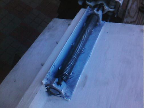

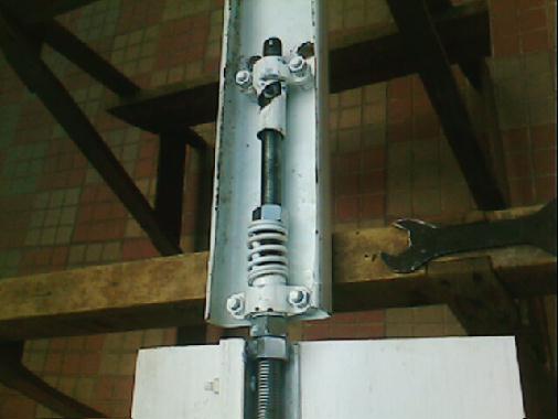

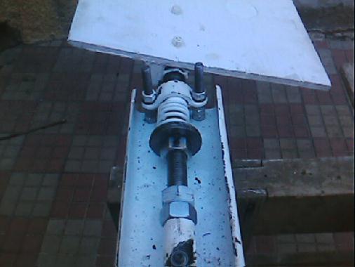

Re: First Genny,....up and running (3.00 / 0) (#20)
by rpcancun (hobbyshopmx@hotmail.com) on Mon Jul 28th, 2008 at 07:59:56 PM MST
Well theres some more pics...it's binding a little where the nut presses onto the spring,...i think i may need a bearing there but lets see how this works, after re adjusting and greasing everything the pitch bounced back pretty well, the good thing about using threaded rod is that i can reverse the blades very easy,  gonna make some lighter airfoiled blades next after i see how it behaves,....what kinda taper would you guys recommend?
I wanted to stay with straight angles so i was thinkin maybe at 1/3 the way down taper to 6".....
Thx
Rob

by rpcancun (hobbyshopmx@hotmail.com) on Sun Jul 27th, 2008 at 10:07:21 PM MST
Yes youre correct I placed the spar one third the way back,...so the wind is pushing it to feather, that was done as a kinda failsafe if the springs broke or softened the wind would try to feather the blades so it can run wild,...i have to take down the blades and do some adjusting ill get ya some pics...
