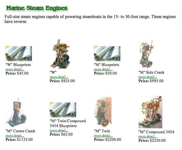

Re: Are there any small steam turbines commerciall (3.00 / 0) (#3)
by dnix71 on Sat Jul 26, 2008 at 12:05:38 PM MST
Here:
http://www.greensteamengine.com

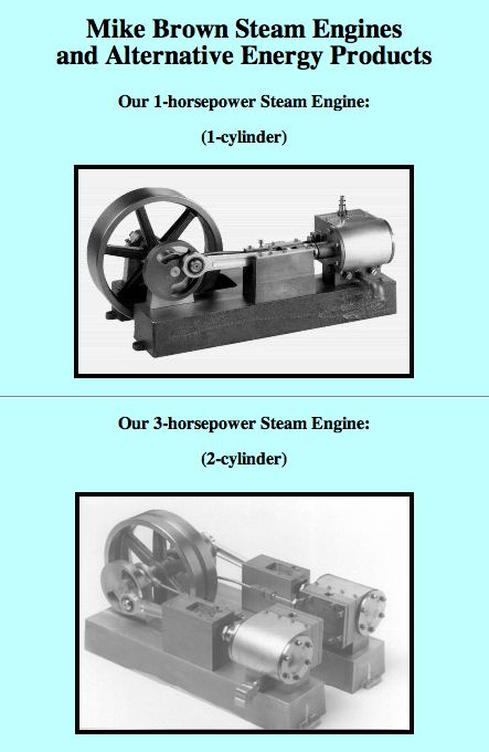

Re: Are there any small steam turbines commerciall (3.00 / 0) (#4)
by dnix71 on Sat Jul 26, 2008 at 12:18:04 PM MST
And here:
http://www.mikebrownsolutions.com/mbsteam.htm

Re: Are there any small steam turbines... (3.00 / 0) (#6)
by Jeff on Sat Jul 26, 2008 at 02:25:01 PM MST
VERY COOL! Thanks Dnix! I checked out #1, the Greensteam engine. Looks like it would easily work with the hot water/ammonia system I was talking about. Nice & cheap price-wise. Even though I'm leary of the efficiency of the design, I think it could easily power a 400-1000watt gen like used on most windmills. Total cost & ease of making one seems pretty reasonable for that. Comments anyone?
I haven't checked out the others you posted, but I definitely will!
Thanks again!

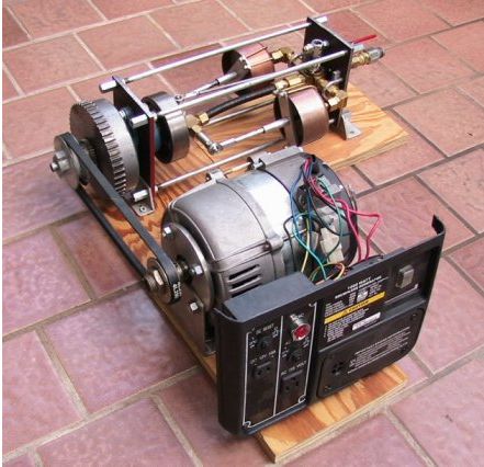

Re: Are there any small steam turbines... (3.00 / 0) (#7)
by scottsAI on Sat Jul 26, 2008 at 05:35:31 PM MST
Ruralmcguyver,
Check out: http://en.wikipedia.org/wiki/Einstein_refrigerator
Works with flat plate solar heat collectors temperatures.
