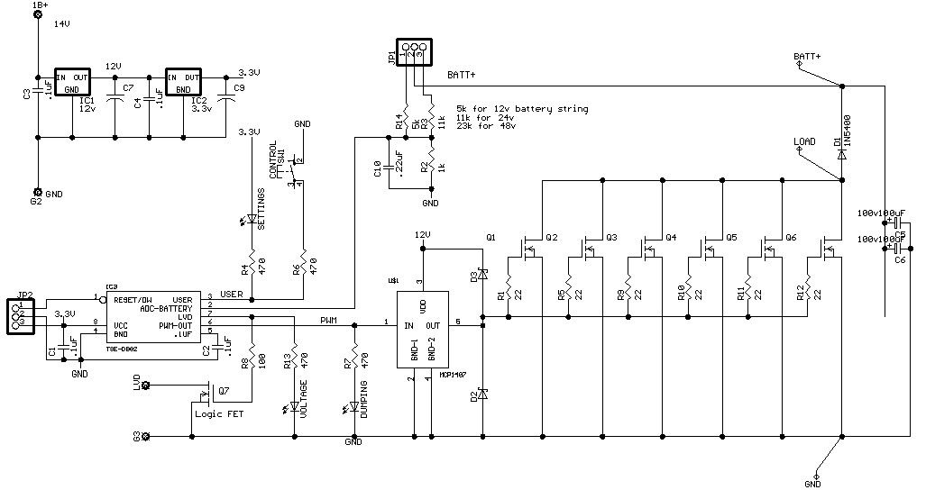

.... I've added LVD and lighting control
My Polar Power lighting controller stopped turning on the night light so I've decided to upgrade my existing dump controller circuit to add that feature.
Since I made that one, I've learned to implement both the button input and LED output functions on a single pin; that creates a spare pin that I can connect to a logic-level FET for switching. The timing of the lighting control (or low voltage disconnect) will be programmed into the chip so I hope that there's no need for additional hardware.
The new schematic is here. While I've drawn the controller chip to show what each pin is used for, it is really a general purpose microcontroller, an ATMEL Tiny85, that I've programmed to do what I want.
I've made a few other changes, hopefully they don't undo any the good advice and help I got in making the existing circuit work:
  1. I've switched from using four discrete transistors as a FET driver (which worked great) to using a driver chip, an MCP1407... mostly because I was able to sample them from MicroChip and I have a few hanging around.
  2. I've put a low pass filter on the battery-string voltage sense line. I've never seen a problem with voltage sensing in this circuit but I did have problems with sensing it in my MPPT circuit so I put it in and hope it doesn't hurt here...
  3. I've added another battery connection for powering the board logic. I want to use LDO voltage regulators to minimize the current draw of the board and most of them have a max input of 20 or 25 volts. With separate battery connections and with proper choice of the output FETs, high side caps and diode, practically any voltage on the dump load can be accommodated. For 12 volt only operation, the second input could be jumpered to the battery string input. Otherwise it should be connected to a battery terminal about 12 volts up from ground. I'm hoping that it doesn't matter if the 12 volt supply browns out from low battery voltage because the FETs would never be turned on under that condition.)
  4. I've added a jumper for changing the input sensing voltage. (I wire my battery bank for 12 volts in the Summer and early Fall when winds are low and 24 volts otherwise.) All the voltage levels were programmable in the previous circuit; however, I frequently found myself hurried punching in the numbers to change voltages. The new controller will be programmed to model a single battery cell and then I use a voltage divider to scale the battery bank voltage down to one cell.
Well, there you have it... if anything looks stupid please let me know. I'm not an EE so I'm prone to ignorance about things which might be obvious to more experienced folk.
Thanks again,
 - Ed.

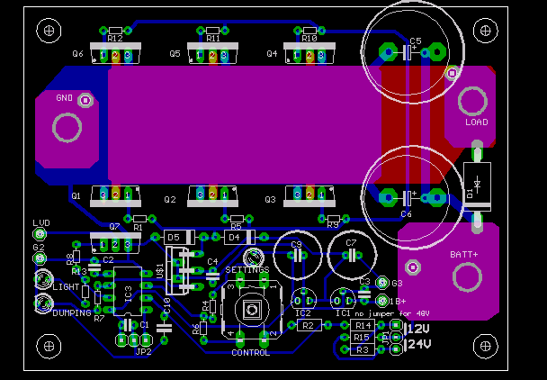

The specs for this controller are in other posts but briefly, it's a temperature compensated PWM dump controller with an automatic voltage boost from float level to charge level after it's detected a voltage drop... it's not as smart are a real charge controller but I think it's a usefull step in the right direction. Total cost to build a 30-40 amp version is about $25 USD.
I've done a layout for the circuit:
(Click here to see it at full resolution.)
The layout of the high power section is nearly identical to that of the existing controller. I reduced the number of caps from four to two to allow a little more room for heatsinks. The big caps are needed to protect from voltages spikes cause by inductance in the battery cable; the big diode protects from spikes caused by inductance in the load... this layout and circuit has been working very well. (Thanks everyone!)
The control sections is routed completely on one layer. I tweaked the autorouting to get the best ground routing that I could. So, even through the board is two layers, the only things on the top layer are power planes and they are very forgiving of alignment with the bottom layer. (It's as easy a two layer etching job as possible.)
Since I posted the schematic, I remembered ScottsAI showing me a nicer way to select reference voltages by shorting connections rather than by making them. The result is that I could selected three voltages with the three position jumper so I added another resistor to support a 48 volt connection. That change can be seen in the lower right part of the control section layout, the difference in the previous schematic is show here:
I've gotten so much help from the board getting this working that I really hope that others can benefit from it as well. If nothing else, for other folks that do digital circuits but are iffy on power electronics, the discrete four transistor driver and big caps and diode protecting the FETs (used since version 2) has worked great; it should be applicable to other PWM applications.
And if anyone wants to build this or an equivalent control circuit, I would be very happy to post artwork and provide preprogrammed controller chips at cost to help you along the way.
 - Ed
Re: Digital dump controller version 3 (3.00 / 0) (#2)
by scottsAI (user name at eml dot cc) on Tue Jul 29th, 2008 at 09:08:00 PM MST
Elf,
CPU PIN:
  1. - connection not shown no comment!-)
  2. - ADC input, Higher input impedance. If for some reason input voltage goes above CPU supply rail, want to limit the current to couple hundred microamps. Else consider diode protection to Vcc and gnd.
  3. - Pin pulled to ground will light LED, Switch: is this an input to micro or to turn on LED dimmer?
  4. - gnd OK
  5. - Not used? Why the cap?
  6. /7 nice dual use of pins.
  7. Vcc OK.
Rest of the circuit looks straight forward, OK.
Concerns on pin 2 and 3, let me know what you end up doing.
Have fun,
Scott.
Re: Digital dump controller version 3 (3.00 / 0) (#3)
by elt on Wed Jul 30th, 2008 at 06:47:00 AM MST
Hi Scott,
It's very nice to hear from you.
  1. The pin is used to program the chip (via the JP2 header.)
  2. I have no great understanding of "impedance." The datasheet says that the ADC is optimized for 10K and I figured that the resistor values were in that range... since it's only sampling at about 1KHz, I suppose the values can go higher. Thank you for pointing this out... one reason that I wanted to redo the existing dumper was that it wasn't quite rated to handle the mill without the batteries attached. (I'm not looking to generate heat, just to be able to do some maintenance while the wind is blowing.)
  3. Assuming that I'm not out there during a gale, perhaps 3x battery voltage is enough? ... that'd be about 8 volts at the input. Limiting to 250uA would require 32K ohm. Give or take the existing resistance in the voltage divider, I should throw in a 22K resistor at the input pin of the ADC?
  4. This works great! It implements and X10-like one button, one LED user interface. When the pin is an output, the controller flashes the LED. The resistor on the switch side (R6) protects the controller output if the user pushes the button while the output is high. When configured as an input, the voltage doesn't go to zero when the button is pushed but, assuming a 2+ volt drop across the LED, it does go down to logic zero (.2Vcc) ... I do see that the voltage is borderline, I'll make R4 680 ohm to bring it down a little bit more. Lighting the LED while the button is pushed is an artifact but I can call it a "feature" :) as it does provide some feedback that the button made contact.
  5. The cap is used to decouple the internal 2.56V voltage reference.
  6. Thank you. Without the pull down resistors, the FETs turn on for a blink while the pins are floating. The resistors stop that; the LEDs are optional.
Thanks again!
 - Ed.
