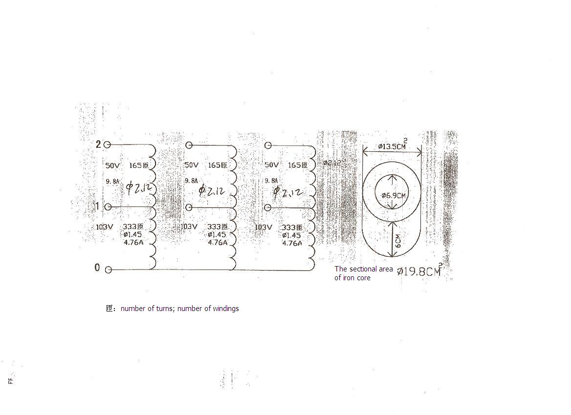

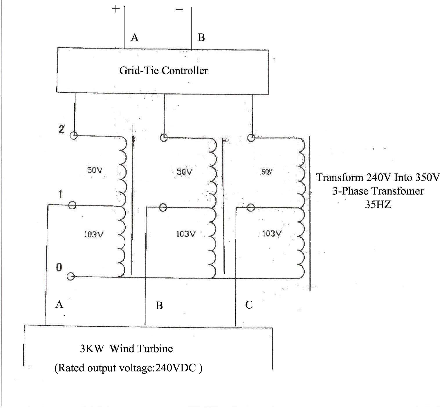

I have attached the plans for the transformers that the manufacturer sent me.  they say the output voltage of the turbine is 240v and the output voltage of the transformer is 350v.  So am I right in thinking I should be re-winding to 350v.
Thanks again for all the help.  Hope the pics aint to big.
Dee.

If you get it rewound with wire with the cross section reduced in proportion to the increase in turns ratio you'll get the same percentage loss at any given POWER output.  It will do the same thing as your external transformers, but without their losses.
A motor or generator is just a transformer with one of the coils replaced by a magnetized rotor.  You can adjust current and voltage, keeping the power (product of current and voltage) constant by adjusting the turns ratio.  And if you keep the same total cross-section of copper in a coil you have the same resistive losses at a given POWER and RPM combination (except for eddy current losses which go down with thinner wire).
