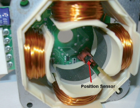

Re: need help (3.00 / 0) (#14)
by dnix71 (yahoo.com 'dnix71') on Tue Aug 12th, 2008 at 10:06:18 PM MST
The best filler is iron filings/powder mixed with epoxy. Air doesn't store inductance like iron does.
I don't know about turning the coils. The picture is an example of a brushless motor. The grey in front of the white plastic winding holders is a stack of flat steel sheets that help reduce the air gap by following the curve of the rotor magnets as they turn. In this case you are running it "backwards" by spinning the rotor to induce a current in the winding. The flat stacks focus the field and reduce eddys in the coil assembly. Filing or powder can do the same thing.
The reason for three separate windings is in case one sets shorts or otherwise fails.
If they are isolated with diode bridges, then you will still get the output from the remaining good ones, and with the alternating windings the arrangement will still be somewhat balanced.

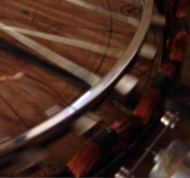

Re: need help (3.00 / 0) (#29)
by dnix71 (yahoo.com 'dnix71') on Wed Aug 13th, 2008 at 05:14:02 PM MST
Here is a screen cap selection showing the air gap. The magnets are round and become invisible when the hub turns.

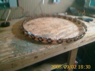

here's the new slator (3.00 / 0) (#32)
by raine (draine@dyocore.com) on Tue Sep 2nd, 2008 at 08:42:44 PM MST
27 coils with a 1/2" x 3/4" oval center set in resin. I'm going to test this tomorrow.  my question is - do the coils have to be touching?  As you can see I have about 1 1/2" space between coils.  will this cause a problem?
I used a Star configuration with 21 g wiring - 150 turns.
I'll post a final test tomorrow sometime.
