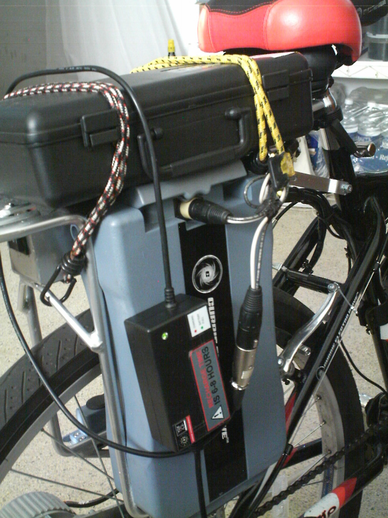

  Just got my 48v ebike kit installed and looking to charge the 48v 12ah SLA battery pack on my 12v system without breaking anything.   The AC to DC charger is only 90 watts max. (60vdc @ 1.5amp) The big question is, will my modified sign wave inverter toast the charge, or my I good to go?  Just like to know if anyone else has done this, and killed their charger! This charger was not cheap!  Blessings, Snow Crow

 The 48V charger will be just fine :)
I use a small 150watter to run the e-bike charger on our daughter's bike, it has 18Ahr's worth on NiCds on it and has been doing just fine. The SLAs it came with were POSes :-)
The unit we use; I picked up at a Pilot truck stop while on sale for less than $20USD and plugs into a cig outlet, that is merely connected to my bank on my HF panels.
Been doing it this way for months now.
Which e-bike did you purchase?
We picked the E-xtreme 550watter.

  Thanks Bruce, I've got a couple small inverters (400 and 375 watt). I purchased the Crystalyte Roadrunner, it came with a 48v 25amp (1200watt)controller, rear hub motor (already laced on steel rim), and throttle with power, low volt LED's  It go right along on level pavement, 25mph to 35mph, 16 no peddle miles and does short steep hill fine as well.  Blessings, Snow Crow

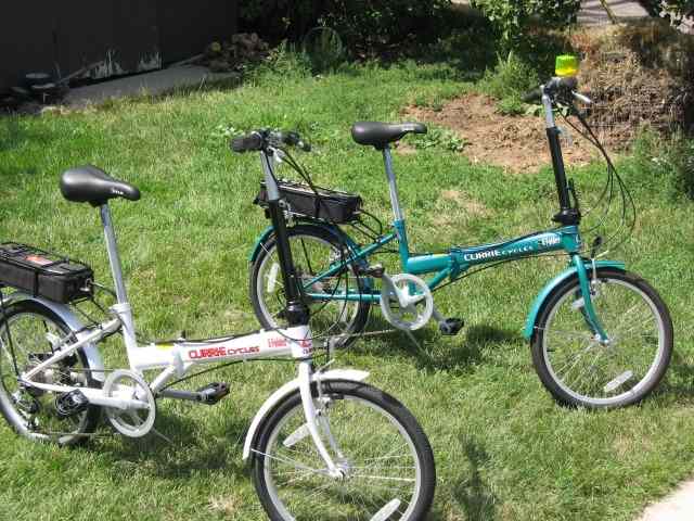

by zap (bell47g5a at comcast dot net) on Wed Aug 13th, 2008 at 05:33:48 PM MST
I'm glad you're making progress Snow Crow.
I was wondering the same thing.
I picked these two up last night, one of the chargers was old, original, and obviously has a good size transformer in it because it's a brick! (about the same size as a brick also)  I used my old Xantrex Power pack on it and it worked fine.
The other charger is newer, about 1/4 the size and weighs next to nothing, I assume it's all electronic.
I've always seen warnings on inverters warning about plugging in battery operated tool chargers and such so I was reluctant to try the inverter on that one.
Going by Bruce's experience, it seems like it would be OK.
Snow Crow how about some pictures?  Or are you saving those for a diary entry?

Hey zap, nice little beach cruisers you have there ;> Looks like they fold up, great for taking on vacation!!  Yes, I'll be doing a diary entry soon and post some pictures. Safe travels, Snow Crow

I got the bikes of Craigslist, I couldn't pass on the price.  They are the Currie E-Folder model.  The original owner got them in 2001 and I got them from his sister.  She had them tuned up and had new batteries installed last year or the year before with the intent of riding them but never did.  They can't have more than 100 miles on them and I wouldn't be surprised if they had less than half of that.

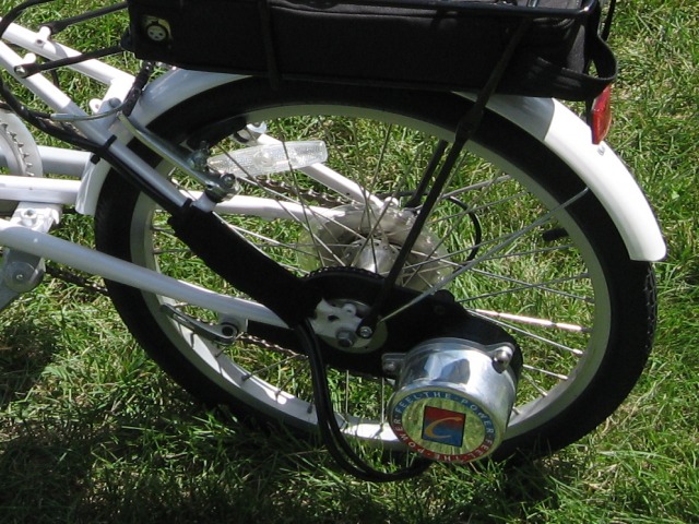

24v external motor, 7 speed, folding.  Here's a closeup of the motor.
Here's a place with a kit that's no longer available, my drive unit is somewhat similar.  Click on the picture of the kit for a closer look.
I weighed the bike today, 60 lbs!!!  About 17 lbs of that is the battery and it's bag, internal tray, and wiring.
I also did a test ride and rode it till I saw a fairly steady 22v under load from a meter I mounted on the handlebar.  30 minutes, 5.9 miles, 11.6 mph average, all with out any pedaling.  I also put the Kill-A-Watt on the charger afterwards and about 4 hours later it was showing 0.13 Kwh.  I didn't think that was too shabby a ride on about $0.013 worth of Xcel Energy.
