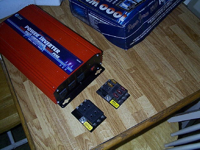

 I found a Victor 1000w inverter on Criglist and picked up for 50 bucks.

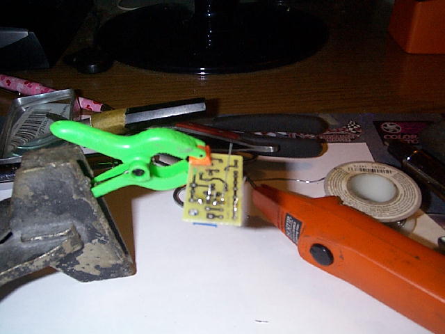

The GHurd controller is under construction now! More on that later.

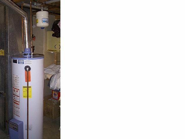

My son and I replaced our existing gas hot water heater with a new one from Sears the
other one was leaking and not very efficient.

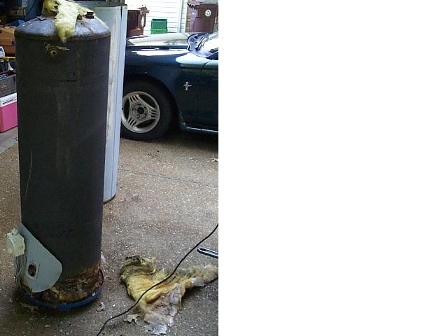

I kept the old one thinking maybe strip it and paint it black to solar pre-heat water for the
new one. I really do not think its worth it though  sense it has a leak. Recently I went to
Lowes and seen a new one that had been sideswiped by a forklift , the first time I seen it
100 bucks! 2 days later it was 50 bucks, the next day 25 bucks, I didn't get that day but
went back to get it and of course it was gone. Snooze you loose applies here!

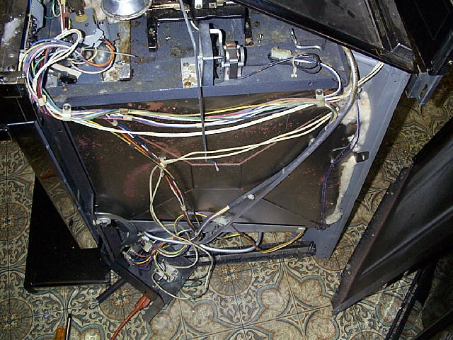

While the rest of the family went on a vacation I run some new gas lines to the kitchen to
install a gas range and get rid of the ele one. One of the igniters was not working and I
had to fix that, it was just shorting out. Taking the stove apart was a real treat.
 Sense the gas range requires ele to start I did some wiring for that. I also installed a extra
outlet and run a wire into the basement for a future hookup to the inverter if needed. Of
course after I did all this the price of natural gas went up 40%.

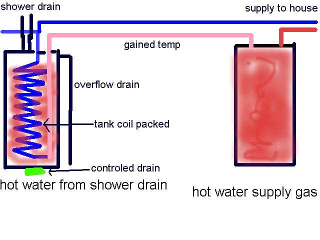

I cant see where coils around the out side of a pipe momently coming in contact with heat will do it. This I think is better.
mixerman

The coils round the side of the pipe apparently do work because (if you've set things up correctly) when showering a thin film of water runs down the inside of the waste pipe transferring its heat very effectively and flow is not impeded.
A grey-water sump as you have shown will accumulate 'bath hair' and worse and breed exciting biofilms and worse IMHO!
Re: What I have been doing, Solar and Conservation (3.00 / 0) (#20)
by BigBreaker on Mon Aug 25th, 2008 at 08:07:17 AM MST
I agree with Damon on grey-water.  It shouldn't stand for more than 24 hours and it should never go through regular (small) valves, tight curves, traps or diameter reducers.  The hassle of pulling out the hair will cause the project to be abandoned.  It will clog.
Perhaps a flapper valve and toilet hardware would work?
For grey water think big diameters and slow.
Re: What I have been doing, Solar and Conservation (3.00 / 0) (#21)
by mixerman on Mon Aug 25th, 2008 at 08:42:15 AM MST
I think what is meant is a virtical drain pipe is coiled on its outside not in any direct contact with the heated gray water.
In my pictue you will see that the coils are in contact with the gray water, Im sure this would allow for some kind of build up! (soap scum, hair, cooties)the core of the tank would be self-contained though! Dont really know if the build up would really effect its effenecy or create some kind of hassard.
The plumbing would remain the same size in use in the system 1 1/2" traps should work fine , the existing drain traps have never cloged in 20 years. For a controled drain maybe a ele t-stat! I think some cas have them today.
Re: What I have been doing, Solar and Conservation (3.00 / 0) (#22)
by BigBreaker on Tue Aug 26th, 2008 at 09:03:15 AM MST
I think the coils in the grey water tank will get some build up.  Also that tank will need to be totally drained daily to avoid having it go septic.  I would consider putting the coils on the outside of the tank rather than inside.

If you can fix the leak in the old gas water heater you  can  strip out the burner an use the flue as a heat exchanger
 This is what I have been using  with my Out door wood stove  to heat my hot water
Here is a link to my wood stove saga
http://oldf.homestead.com/Woodmasterishere.html
An look in to using PEX tubing  for the long runs a lot cheaper than copper
Old F
Re: What I have been doing, Solar and Conservation (3.00 / 0) (#16)
by mixerman on Sat Aug 23rd, 2008 at 06:33:38 PM MST
That is a good idea! I like your stove. Have you ever stripped one of those tanks with the hot wire?
I forgot about there being a center in that tank, that changes things!

Had some time Labor day so I cut the jacket off the old water heater. The installation that
was around it was a joke, about 1 inch. No wonder the laundry room was the warmest
room in the basement.  Its been rolling round in the back of my pickup sense Monday and
it has knocked some of the calcium loose.
 Anyone know the best way to get the calcium out of the inside of the tank?

I tryed to add another picture here but no go.
Re: What I have been doing, Solar and Conservation (3.00 / 0) (#24)
by mixerman on Thu Sep 4th, 2008 at 08:37:03 AM MST
Thats better!
Re: What I have been doing, Solar and Conservation (3.00 / 0) (#25)
by DamonHD (d@hd.org) on Thu Sep 4th, 2008 at 09:09:58 AM MST
Descaling agent?
