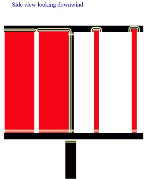

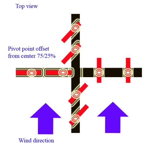

The ideas have been swirling in my head like a VAWT turning at 30 RPM and I came up with a super simple design that I don't think I've seen mentioned around here.
In this Top View, the Dark Blue lines are pipes or Square tubing would be better, The Purple Lines are Large Flat Panels that are hinged to the pipes. When the panels are going Upwind they are unfolded and pointed directly into the wind, or furled. As the panels rotate into the wind they will fold in and rest against their Supporting pipes, eventualy becoming Flat to the wind  as the Working Panel. As the panels continue to rotate around the downwind side and back into the wind it will swing back out open to the wind. I hope the drawing can describe it better than my words.
A few of thoughts . . .
The panels should be very light to operate at high RPMs.
Centripedal force may prevent the panels from folding in properly
  but this may be a way for it to furl.
The downwind panel is being shaded from the wind by the working panel
  possibly interfering with the swing-out operation.
The centripedal force from the panel swinging out might give the system a little Kick.
Smaller Panels on longer arms may give better results.
Could be noisey
So I'm wondering . . . Will it fly ?

 I think the basic problem is in how you have the panels hinged. the centripedal forces would make them always want to be in the outward position.
 The biggest problem i see with folding panel VAWT's is the niose they would make "slapping" into position. Here's a down and dirty description of a similar device I've had bouncing around in my brain.
 The wind force would act on the panels forcing them open and closed when in the respective positions, due to the offset of the pivot point, so no complicated gearing mechanism would be required.
 Stops on the cross bracing would prevent the panels from going past the center point,when in fully closed position. I believe a design of this nature would increase the efficiency of a VAWT greatly, at the expense of keeping everyone awake for several city blocks!
 There is also the problem of side stress due to all the loading being on one side during rotation.

Yes it will.
Will it be fun to make? Yes
Can it be an 'eyecatcher'? yes
Will it be efficient for generating energy? no
just my opinion..

A fancy version of a savonius rotor, high torque, low efficiency and with flapping vanes noisy as hell.

The idea goes for tsr < 1,that means the 'sails' are moving slower then the windspeed,
the blades are alternatively 'sailing' upwind and downwind.
If you're going to do a design for tsr > 1,the blades are sailing upwind all the way around.In fact,that's a darius.
The bigger the tsr,the less it will need adjustment of the blades.
Personally I'm thinking of a kind of darius,with 'passive' adjustment.
If you make the 'sails' of a darius some kind of flexible they will be 'pushed' in a better position just by the pressure of the wind.
Well,that's what I hope.Probably there are some problems I don't think of yet.
Any way,the mechanics needed for ajusting the blades in the exemples you mentioned is a real handicap for this kind of design.

Woof, ... it will turn, it will be slow and unless it is gigantic not much power will come from it, ...just my opinion, sorry.
