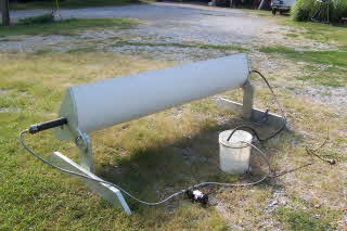

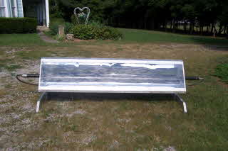

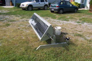

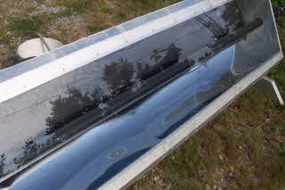

I just completed my first parabolic concentrator trough for solar hot water!
This unit is only a prototype made out of marine plywood 2x4s plexiglass & plastic mirror.
The final product will have a aluminum frame,bows & housing with a polished stainless steel mirror & tempered glass cover.
I am using a deep focus trough with a glass cover & insulation between mirror & back in order to keep ambient air off of collecter tube.

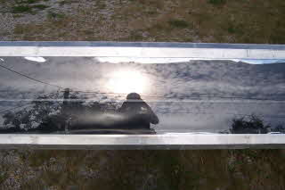

In test results on the partly cloudy day that these pictures were taken the trough raised the temperature of 5 gallons of water 30 degrees in the first hour & continues to climb as I am posting this message, last check 160 degree water.
You can see the clouds in the reflection of the mirror in the picture above. You can also see some distortion of the plastic mirror in the above picture ie . you should see the black pipe all the way across the parabola. The distortion of the plastic mirror gets worse as the temperature in the trough rises. Hopefully the polished stainless sheet will behave better!

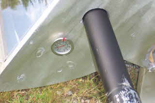

This final picture is of the thermostat in the end of the trough that keeps trak of air temperature inside the trough 150 degrees at last check.
I am very pleased with the prototype & will test it this winter for heating my battery storage shed before I sink the money into the final version with sun tracking.

Interesting design, do you think that you should insulate the stainless mirror from behind to keep the ambient inside temperature up (the plastic did it for you here I think).
Neat example of heating up above the passive ones.
.........oztules
Re: My Parabolic Trough Water Heater (3.00 / 0) (#5)
by brianc4 on Mon Aug 25th, 2008 at 03:39:56 PM MST
oztules,
   On the prototype in this post I used 3-1/2" fiberglass batt insulation between the back of the mirror & the plastic back on the trough.
   For the final unit I may have a local contractor spray in polyisolene insulation.
   Also considering double pane glass on the front for a dead air gap & better insulation.
   I think that the parabolic style solar water heater can work well even in a cold climate if the collector tube is protected from ambient air.
Any thoughts on insulation or glass for front cover would be appreciated.
Brian
