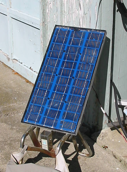

I did some testing with the 36 cell, 12 volt panel I made and it wasn't as good as I hoped; I expected around 20 watts but it suffers heat fade badly ... without any load it quickly drops from 20 volts open circuit to about 15 volts. :(
Connected to a fully charged 12v 200 AH battery bank it does make float volts producing .51 amps at 13.4 volts ... 6.834 watts

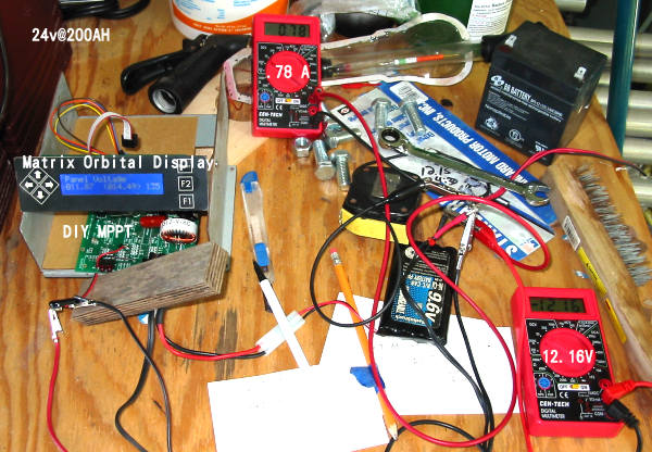

I connected the panel to the MPPT booster I made and a 24 volt 200 AH battery bank:
I used a serial LCD for debug and testing. The LCD isn't need to run the booster and the power usage given for the booster (.015mA@ 7 volts) is without the LCD.
In use, controller draws .78 amps at 12.16 volts = 9.485 watts out of the solar panel. At that time the battery bank was at 25.4 volts and taking in .33 amps = 8.382 watts. 8.382/9.485 = 88.4% efficiency. In this case, the open circuit voltage is 15.1 volts and the controller is programed to load the panel to 80% of the open circuit voltage.
The little micro running the booster is power hungry and consumes 90 milliwatts to the net power produced is 8.292 watts.
Compared to the 6.834 watts going into the 12 volt bank, boosting it and getting 8.292 watts into the 24 volts bank represents a 8.292/6.834 = 21.3% gain in power.
Whoopee!
I was surprised to see that over time the battery volts raised to 26.8 volts, I thought more power would be needed to reach float volts.
Anyway, it's just a basic booster circuit (cause I don't know how to do better!) The logic FET is driven by one of the processors PWM pins at 72KHz. It adjusts the duty cycle to load down the panel to about 80% of the open circuit voltage. Every two seconds it unloads the panel for 15 ms and checks the open circuit voltage again.

The logic FET is driven by one of the processors PWM pins at 72MHz.
I trust that is a typo?
If the current going into the battery was an analog input to the micro, you could dither the pwm, see which gives the greater current, then move the average pwm in that direction.
Re: Small scale solar MPPT wins 21% (3.00 / 0) (#2)
by elt on Tue Aug 26th, 2008 at 06:15:42 PM MST
Hi Amanda,
That sure is a typo! But it's only off by thirty ... db.
The micro switches the FET at 72KHz (k_i_l_o_h_e_r_t_z), thanks for pointing that out.

Just a comment about C3 and C2. I dont want to start a flame war about this but I would not remove those capacitors from the circuit and this is why.
Removing those will enable track and wire inductance to act as an open circuit for very small time. Hard to explain but here it goes.
Current in an inductor increases with time. At t=0, when mosfet switches off (t=time) the inductor will be an open circuit. This would be very bad for your mosfet as the voltage spike created by the boost converter will have no place to go, thus nothing to clamp that voltage down. That situation might enable that voltage to exceed your mosfet's Vgs.
Another thing is that with such a fast dV/dt (rate of change of voltage) the parasitic capacitor between the drain and the mosfet gate will create a voltage in the gate. This is very very bad as this voltage will turn on the mosfet when it should not be on.
If you make the path from your mosfet drain-diode-C3 very very short you will be running on the safe side as this huge spike's energy will just be stored in C3. C3 will not let the voltage spike so high then.
It is extremely important for the survival of the booster that the output inductance it sees is minimal, and that is achieved by shortening tracks and adding capacitance.
I am not great at explaining things but I hope you get the idea.

  I don't understand the blue glazing . The circuit is interesting C3 can go away it's just there to keep the ripple shunted . batteries like ripple just fine As a matter of fact the caps won't react at all across a battery . looks like your wasting power at Qi   Sb540 is a 5A schottky . Looks like fun
Re: Small scale solar MPPT wins 21% (3.00 / 0) (#5)
by elt on Wed Aug 27th, 2008 at 08:24:01 AM MST
In hindsight, it was probably a mistake - I thought that painting the inside of the box blue would make it look more like a "real" panel at a distance. Now I think that it adds to the heating and voltage loss. At any rate, the glazing is clear Lexan.
> [...] C3 can go away
C3 is a .22 uF polypropylene cap; IIRC, it was suggested that I put one in a different design to protect the FET from switching spikes and I just copied it into this one. That cap is big and expensive, I'd be happy to put it back in the cap pile if you think it's not needed here.

There's no spikes the battery doesn't obsorb here and no doubt the caps is retaining battery voltage . Keep working on it

Back ground of panel should be white or silver to reflect light between cells. Reduces heating.
Cooling panel is an option, many ways to do this. Some are even practical.
Large panel active cooling system can be worth doing. Stay above dew point.

Regarding my panel, I should be able to slip some silver mylar between the gaps in the rows to cut down on the heating. I have some left over so I will give that a try.
