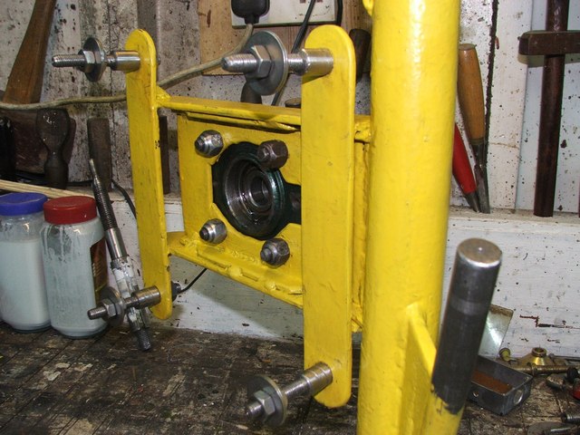

  with a bit more work done on the mill .i had to make sum new mods.
  with the second rotor finished and fitting on the shaft i was now ready
 to start with testing coils.
   in fact i was itching to test the coils and check it all out for cut in.
   my coil winder was ready to go.
    but i had to sort sum things out.  things that needed welding grinding etc.
   i thought it best to leave the coil winding a stator building to last.
    so got on with the dirty work cutting and welding.

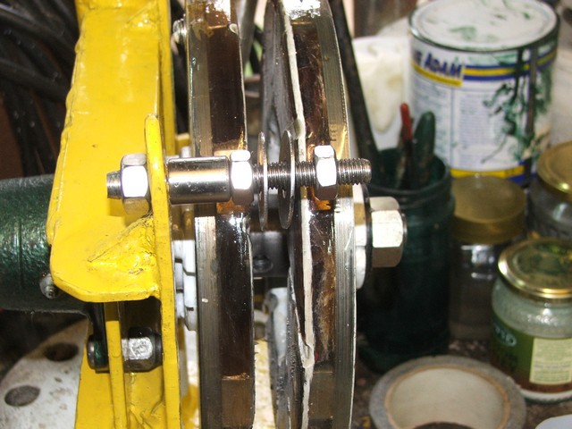

    i made sum new mounts for the stator. and also made from 316 stainless
  new studding .
  this had 12mm thread on the frame and 10mm thread on stator.
    i made from a scrap shaft i made for the mark one .so that was lucky.
     with all the new bits welded i gave it a coat of paint(again)
    i had no blue left so used yellow. (now its called the yellow  peril)

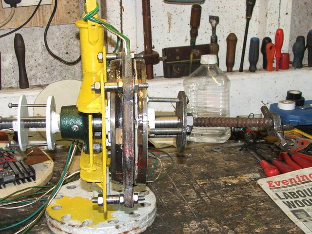

    happy with what i done i started to think about the new stator.
    now i run into a problem. whare i had the jacking screws fitted
  it fualed on the inside of the stator.
    and as its only a mini gen with a 9" rotor i had no room on the inside of the
 stator  to allow for jacking screws.  what a pain this was turning out to be.
     the jacking screws worked well with just the two rotors in position
   but the hole in the middle was now to small.

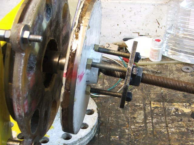

    but after a nights sleep i got the idea to use the same jacking screws but in a different way .
  so i made up a puller with scrap bits.
  used the same threaded holes.  and now fitted into the end of the shaft,
    so i had a bit luck there.
  shaft was a bit on the short side so had to make a small extension .
   and now i can pull the rotor off till its past the pull of the other rotor.
 i forgot how little room there was inside the small stator.

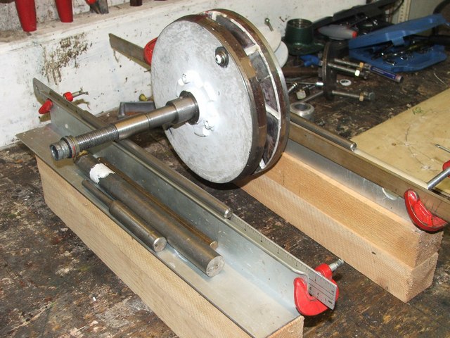

  also i played about with balancing the two rotors on there shaft.
  it needed a bit added. why you ask did it need a bit added.
   well when i cut out four mags i had in the wrong way.  i don't think i got them back in right.
   couldn't use the magnet jig now. wouldn't fit.
   or just maybe sum thing else.
    but im happy with the balance now.(considering)

stator mount upgrade | 7 comments (7 topical, 0 editorial)

Yes, very cool. I used to use a puller similar to that arrangement when I used to build machines out of brake discs. Mine just slipped inside the inner center hole and used a stop turned up against the top of the threaded rod studs passing through the bearing hub. It worked well, but there is no substitute for nicely placed jacking screws. :-)
Well thought out solution :-)

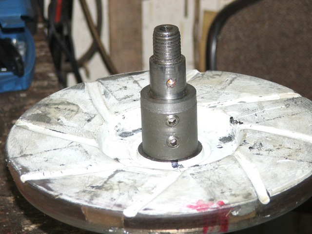

I also like your cooling fins (channels) cast into the rotors. Do you have a hole in the center of the rear disc to allow air to get in? If not, you might want to think about drilling some toward the center of the rear rotor. It has to be the rear rotor because in most instances the front rotor is blocked up by the prop that is installed.

 hi all. this was just a few mods i had to do before i move on to the stator.
  but i see i can make the hole in the stator what size i want.
  it will just let the air flow the bigger it is.
   so i have made the stator but kept the hole as big as i could.
