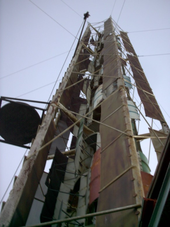

Re: VAWT land (3.00 / 0) (#7)
by luckeydog (bryan@coloradowindpower.com) on Sat Aug 30th, 2008 at 11:52:56 PM MST
(User Info) http://www.coloradowindpower.com
you can use 55 gal. barrels like this monster 50 ft. tall and 6ft wide
wind gens are much funner to watch than solar panels. Broomfield,Colorado
Re: VAWT land (3.00 / 0) (#8)
by tecker on Sun Aug 31st, 2008 at 06:11:56 AM MST
 The 55 gal barrel is heavy enough to weld together and hold together . I can move these around and not loose the balamce and when  up to 150 rpm they have torque that loads up nicely .
