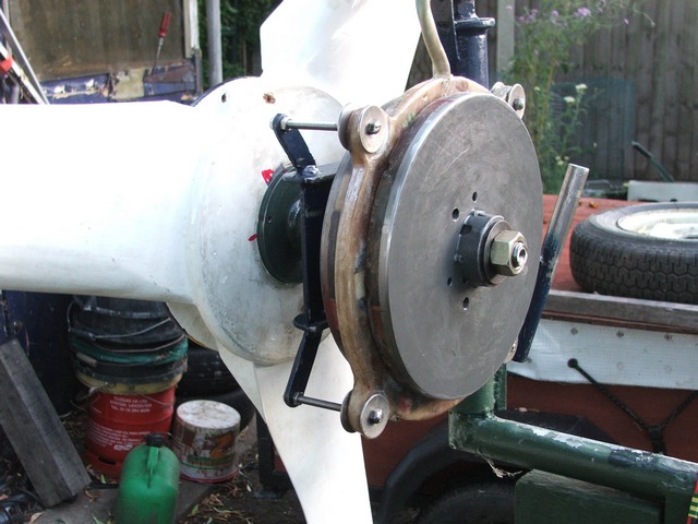

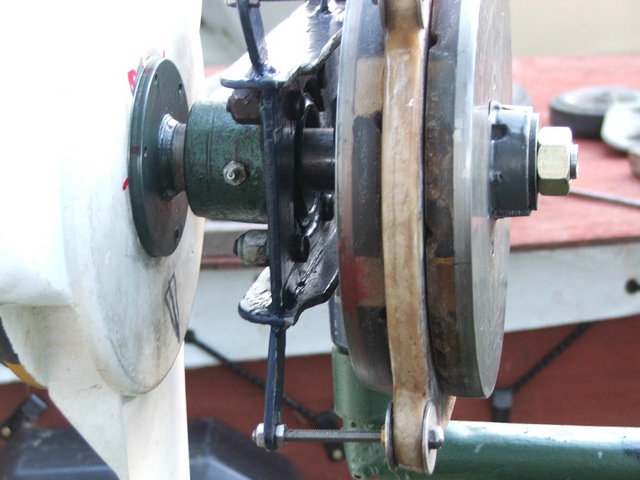

  at long last i got myself a twin rotor .
  its been a while in the making.
  it started as a brake drum and small ceramic rotor.
  then it went to a single rotor 8 mags six coils.
   and now its got 16 mags.

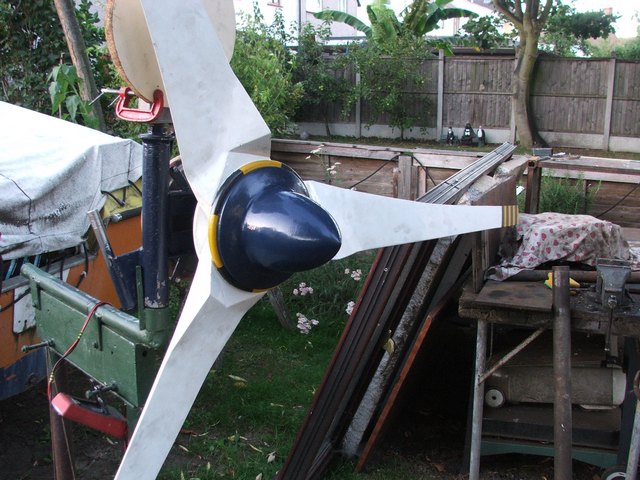

  this is fitted with a six foot prop.
   its more of a mini mill really . but has given me much pleasure in the building.
   its had meny mods done to it .
  so its moving along at a slower pace than just building it from plans.
   learning is the key.  and im sure a 8foot one .that is planned for the future
  will be made in much the same way. but i think much faster.
   other mods i got to do i beef up the studding holding the stator.
   it just gos on .more and more bits to sort out.
   but a great hobby for me . and at the end it will  make itself very useful.
   i dont consider the tower as part of a hobby. but its sumthing you cant do without.
    in the photos the stator is from my first attempt. so its not wound for it.
    my next job. tidy up and get the shack ready for coil winding.
    it will be much better this time making a test coil.  as i understand what
  its all about.
   lots of scrap bits used in the making of this.
    but also lots of bits i paid for.
  excuse the white prop with many black hand prints.
    sumhow my hands are always oily  .
   so far its runs very well. turns in a whisper of wind.
    its a mini turbine but its so heavy.  thats without the tail boom.
    the back rotor is locked on with a nut.   i will add lock tight to all
  bits that can come loose
    i will add pics as to how the prop is fixed. as a matter of interest .
  as yet i dont know how much gap i will need . in the pics its pretty close.
  but turns clear.
   sumtimes i want to take a few pics. but my hands are so oily i dont.
    now im getting to the clean bits will be nice.
    only thing is i cant take it indoors at night .(to study)
    never mind it wont be long now. soon be a flyer.

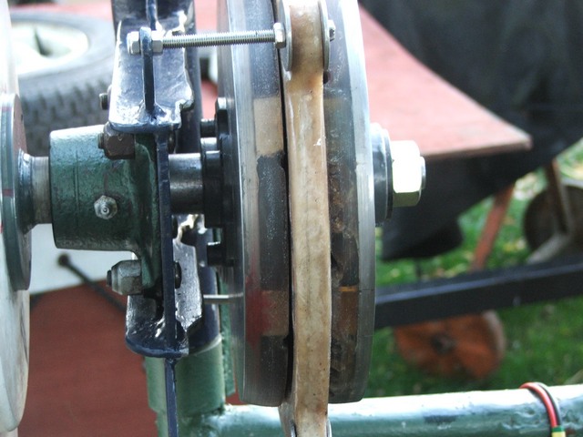

Looks like nice tight mechanical clearance.
And you can be proud of those fingerprints on the blades.

STOP!  Wait a minute, and then check and then think carefully.
I noticed that there is one large nut at the rear holding the magnet / stator assembly on.
Have you locked this nut in such a way that it can never unscrew against the turning direction? Left hand and right hand threads against turning diection etc.  You should know what I mean.
Otherwise well done and keep us informed about power output etc,
David HK
Re: at last a twin rotor (3.00 / 0) (#5)
by David HK on Mon Aug 4th, 2008 at 01:50:15 AM MST
STOP (again).
Take a close look at the nuts that hold the coil casting on. Can they unscrew themselves?
I would hate to all that beautiful work destroyed because not enough attention was paid to these crucial features.
Keep checking the whole machine - this the good thing about posting photographs.
David HK

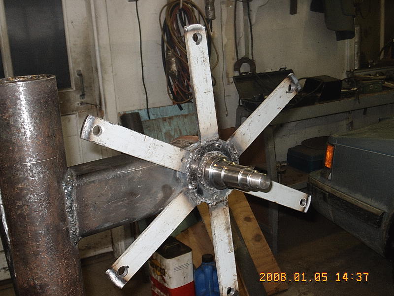

It looks a little spindly on the stator thread . Looks as though it won't deform with the blades aft but the alternator will drag a quick highspeed twist . That looks like 5/16 go to 5/8  .3" long 5/8 thread  takes more Than 150 lbs torque  5/16 is around  than 25 lbs .The stator itself is probably 15 lbs . Some t braces on the stator support is a good idea.
Re: at last a twin rotor (3.00 / 0) (#7)
by Ungrounded Lightning Rod on Mon Aug 4th, 2008 at 07:53:45 PM MST
One thing that has bugged me about these radial designs is that the stator isn't well supported against rotational forces - which is where it's loaded.
Structures like this are strong in compression and tension, but not in bending or torsion.  Forces should be along the length of at least one straight piece, not at right angles to a single support.  Single supports - especially thin ones - should not be twisted.  Joints that may be pushed in more than one direction should be supported in at least two directions in two-D, three directions in three-D, so the supports can divide the load such that they're only loaded in compression or tension.  The members should be connected to form triangles and pyramids, not squares or arms - especially arms with bends.
So think of them as if they had springy flexible joints where they make a corner or are fastened to another member.  How do they bend?
In these designs you have a star of thin radial strips, with allthread at right angles on their ends, supporting a disk that is TWISTED by the main load.  OOPS!
 - When under a torque load the strips are in torsion and act like springs, while the allthread rods act like levers.  The twisting stator is pulled toward the downwind rotor while enormous leverage on the allthread rods tries to fracture the stator where they are attached to it.
 - When loaded along the axis, the strips act like springs in bending, allowing the stator to move in either direction and contact one rotor or the other.  Further, there will be some frequency where it resonates.  Vibration at this frequency will "pump up" a mechanical oscillation until it bounces between the rotors and friction there takes out vibrational energy faster than it is added.  If this frequency happens to match the "singing" at some RPM you're toast.
Seems to me there are a couple things that could be done to fix this.
First:  Stiffen the supports:  Weld on a support against along-axis bending and torsion, making them into a T or L cross-section.  They can be made ever stronger by making the strip and/or the support roughly triangular - wider at the hub than near the attachment of the allthreads.  Alternatively you could use three rods or angle-irons to form a thin pyramid, being sure that they don't all have their planes parallel if they're sheet metal.
Second:  Stiffen the allthreads against the helical analog of the "parallelogram collapse" mode of a square of supports by running a strip from the base of each to a point near the stator's attachment, forming triangles.  This brace will be even stiffer if it can't fold up - which can be done by using an "angle iron" shape rather than a strap.  (Alternatively you could brace in two directions with strip so at least one of each set of braces will be loaded in tension and not subject to fold-up failure modes.)

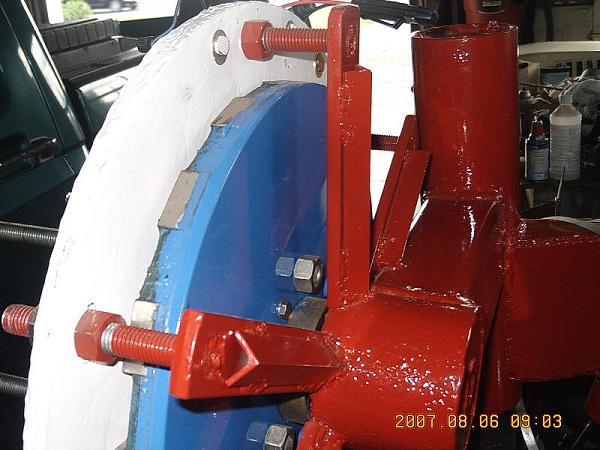

blueyonder:
You have done a nice job in both design and workmanship. You have given the stator lots of room for air cooling.
I tend to agree with tecker and flux concerning the strenght of the stator mounts.
Check out the Dan's 17 ft. designs old and new on this forum. Reinforced stator mounts on the new design.
I have reinforced my stator mounts to try to strengthen rotational torque. Hope these pics help.
lglagasse
pic # 82 is my original design.
pic # 264A is reinforced design

by blueyonder (windwoodgood at yahoo dot co dot uk) on Wed Aug 6th, 2008 at 05:18:28 PM MST
thank you guys for the comments.
  i did say in my first post i got to beef up the studding.
  but after reading the advice about the stator torque.
  which to be honest wasent aware just how strong it can get.
  and also putting the brake on in a howling gale.
  i was going to modify the stator holding brackets anyway.
  but now i am going to rethink on how to make it good.real good.
  as yet i havent had a mill running .so know nuthing about the power out
 or torque made as it generates.
  so its good i am thinging ahead to when its grunting a bit.

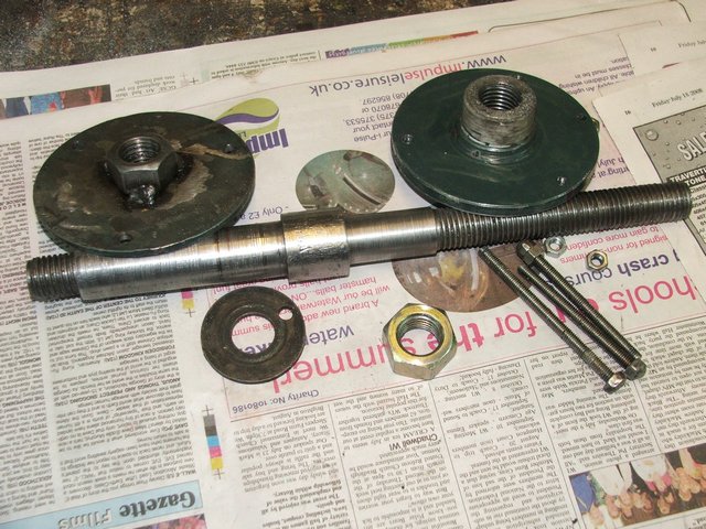

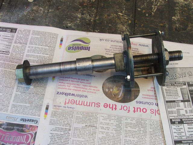

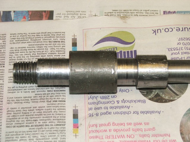

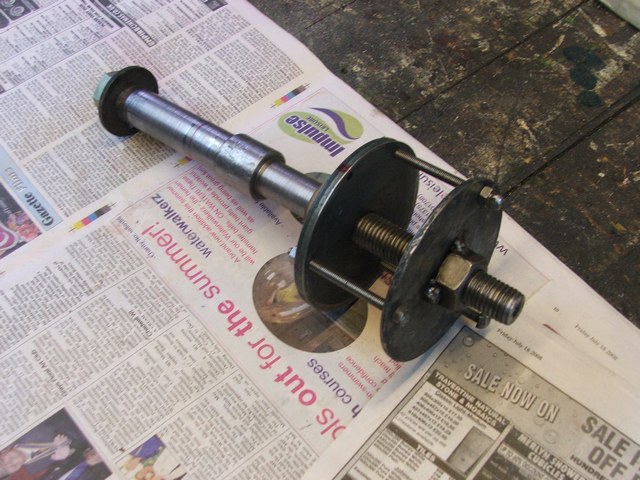

    and as i said in the beginning of the post .i will put sum pics of the shaft.
    should anyone be interested to make comments on it.
    but you need to see the pics first .
    the thread at both ends is metric. its 20mm.
    also made a spacer to fit between the rotors .
    so at 1/2" min air gap i can put a spacer in to make it as wide as i need.
   two bits at the front hold the prop with a  20mm nut on each.
    also three bits studding go through the prop aswell to lock every thing tight .
    the nose cone has a 20mm threaded hole in the back so just screws on.
    i might have a go making castle nuts. 20mm is hard to find lock nuts.
   now to post a few pics.
   if you see any probs with shaft .dont hold back .
   well no one held back saying about the skinny bolts holding the stator.lol.

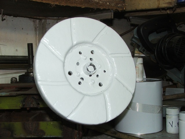

  just saw a pic with a white painted rotor.
   the idea being it might just help it stay a bit cooler. in strong sunshine.
   but more like it will have dirty hand prints on it verry soon.
   i think i will paint stator as well.

     I wanted to ask about how you keep the two magnet rotors aligned. I think my design follows yours somewhat in that I have a center shaft as opposed to the five bolts like we see on the wheel hub design. For that reason I only have magnets on one steel disc so that alignment didn't matter. The second disc was only steel no magnets. But it looks like on your dual rotor you only have one nut holding the rotors on the center shaft and I'm wondering how the alignment went. I'm lousy at explaining these things, did that make sense?
Andy
Re: at last a twin rotor (3.00 / 0) (#15)
by tecker on Fri Aug 8th, 2008 at 01:26:41 AM MST
Magnets have strong attraction .
Re: at last a twin rotor (3.00 / 0) (#16)
by blueyonder (windwoodgood at yahoo dot co dot uk) on Fri Aug 8th, 2008 at 04:12:30 AM MST
 hi andy . what you asked i found very interesting in practice .
   when i was making a shaft to try out two rotors i made a key way.
  as bothe rotors also had a key way.
   fitting this together i had to make sure the key ways were aligned .
  so i could get the key in line.
  but then i saw every time i put the second rotor on with the jacking screws .
  it was always in the right place.
   can you beleave the rotors line themselves up.
  but i do have marks on each rotor so i can just move it a fraction
  for 100% alignment.
   with the small rotors i have .only 8 magnets each . it is possible to twist
   them a small bit. maybe a 1/4" . so i just check out the marks i made.
   (if the other one is locked in place.)
  first time i have used jacking screws.  thay are a must.
  dont ever be tempted not to use jacking screws.
   as the one your trying to put on will pull the other of the shaft
    in short the north pulls the south and vice versa.
    two rotors are twice as much fun and twice as much power.
    double the amount of fun you get andy.
   make a second rotor.
