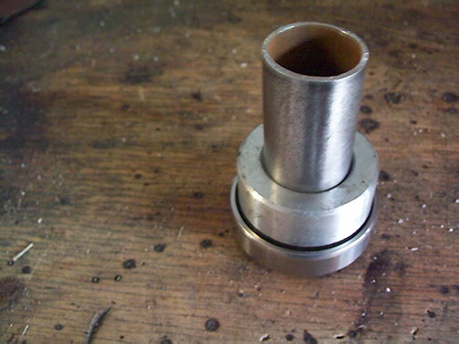

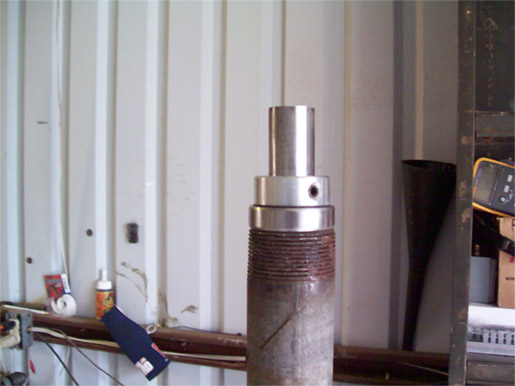

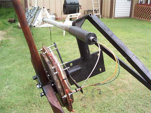

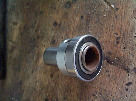

Top swivel bearing
By kc5etv, Section Wind
Posted on Fri Sep 12, 2008 at 12:43:40 AM MST
10 ' Wind Turbine
This has made a BIG Difference, Hope it may help others.

Yes, having a bearing in the yaw assembly does help big time. The only thing I have to say about your arrangement, is that the bearing you chose is not really suited as a thrust bearing. Most of the force (when the tower is raised) will be in a downward direction, perpendicular to the way the bearing is positioned (or supposed to be loaded). This might lead to premature bearing failure down the road, but time will tell. Im sure it will be fine, but keep your eye on it. It would be best to use a tapered roller, or a throw out (clutch) bearing. Something that was meant to take a little more vertical force in that orientation.
Looks good though  :-)
Have Fun!! RoyR KB2UHF

I also used a bearing on the top of my generator. It's been up for about a year. It is much more responsive in light winds. My bearing is a used regular ball bearing I had on hand. I figured if mine fails, the genny will slide down the spud until it reaches the tower and stop there. Be sure the blades can't get into the guy wires if it does fail! OUCH!!!
However,I DO have to agree with Roy about the tapered bearing vs ball bearing. That's the best.
BTW, nice work!
