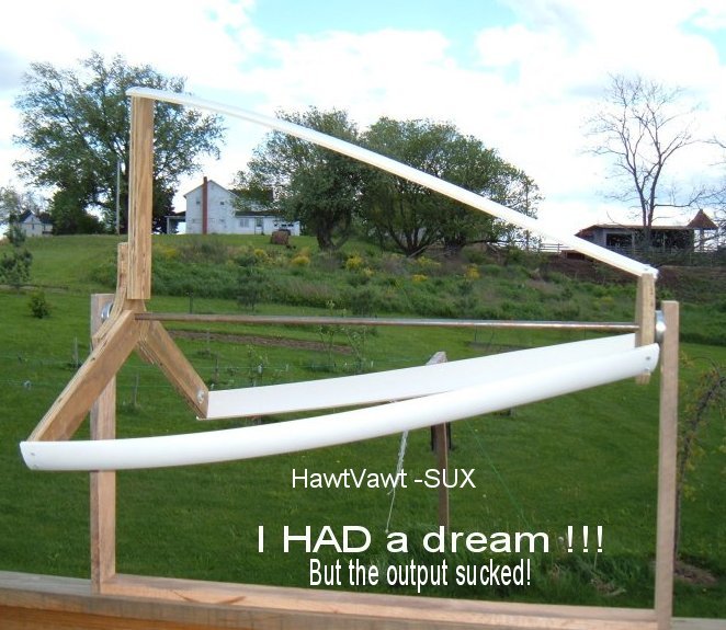

And to think I had thought I was inventing something new!  I never seen that 'Ball mill' before. Earlier this summer, I had a dream about something similar to that and so I built it the next day in a few hours.  I called it the HawtVawt. It was made with PVC pipe. (6")
Maybe next summer I will try again. It did freak me out that it didn't at least work some though.  I even tried flipping the blades backwards-- but no-go.
But I am not too smart, so maybe they figured out something that works!!!
Thanks for sharing the links. Maybe I can find the answer(s) as to why mine did not work.

You seem to be trying to build a Darrieus with the axis horizontal.  This would pull power from a crosswind.
But you need the blades to be an airfoil shape, with a curved leading edge and a pointed trailing edge.  (The wind has to attach to the blade from a number of angles on the curved leading edge and exit at right angles to the axis from the pointed trailing edge.)
And it probably won't be self-starting with just the blades.  So you'll have to spin it up to get it going.  Either by running the genny as a motor or hanging on an extra starter motor, or by attaching a smaller, drag-type self-starting mill, scaled down to get the same RPM despite the drastically different tip speed in normal operation.  (Say a Savonius.  Figure about an 8-to-1 ratio of diameters, since the Savonius will be running at a TSR of about .8 and the Darrieus will want something in the 6-7 range.)

 Nice machine Cmebrew !  The rear should have similar blades as an HAWT to start and maintain the spin, lift from the forward blades would or at least should, in theory, add to the power extraction from lift... The main problem I see is getting the blades up to speed.  You may have never reached the speed they needed to start lifting.
 I'm not a big fan of high speed VAWT's overall because of the constant maintenance.  Basically a failure waiting to happen unless thier watched and inspected continuously.
 Your definately thinking out of the box.. keep it up you'll find success in the strangest places.

In my dream I wanted something different from a Vawt. I wanted something faster than a darrius. It was suppose to be more like that 'ball mill' Rob referred to.  I thought (drempt) it would be much more efficient than a Vawt since all the blades push the same direction,(WAY less drag and opposing forces than a Vawt) and it MIGHT make a nice horizontal vortex once it got going which would (could) add to the speed and such.
It was perfectly balanced and if you slightly pushed anywhere on any of the blades while stopped, it would propel nice in the same direction.  In a good wind (say 16-20mph) , I would spin it fast with my hand, but it would slow down and only turn slowly in the big wind.  It was just a quick, crude proto, but it freaked me out that it didn't do better than it did.  Maybe wider blades that go more vertical??
In my dream the HawtVawt ran like a jet. But in reality it was a nightmare!!

CmeBREW nice thinking out of the box. Awesome machine you built there. From which material did you made those? Is it efficient?
Re: Energy Ball (3.00 / 0) (#11)
by CmeBREW on Sun Sep 21, 2008 at 05:43:53 PM MST
Zeebag-      That prototype I attempted did NOT work at all. No need to even hook a generator up to it. The rotor design was (evidently) a total failure.(so far that is)
