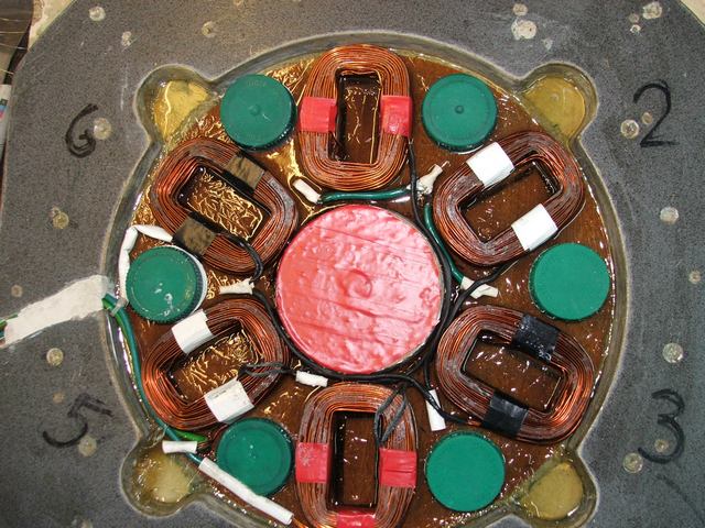

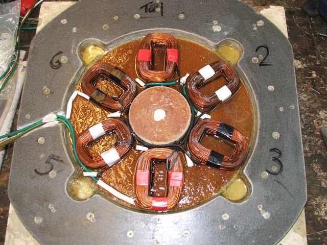

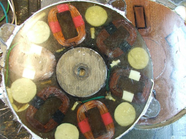

  another bit done to my gen.
  this time i got the coils right.  but now what i did with potting.
   pics will explain a lot.
  first stator i potted got hot. i dident think it was a good thing
 to happen to it.

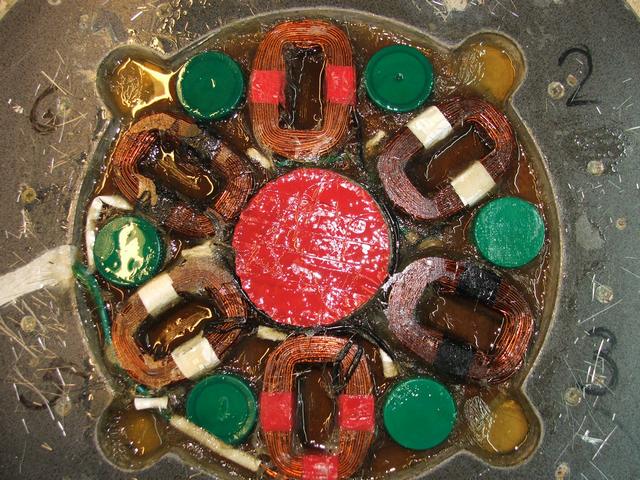

   so this time i mixed three lots of resin .
   first mix i put glass matt in and resin then put coils on top.
   put the lid on mould tight so as to compress everything.
  then second mix with more bits matting and resin. again putting lid on tight.
   final mix with a good covering of matting and resin again putting lid on mould.
   each time leaving it to set and cool down to lose any heat build up.
    it never got hot and set very well.
    so i never added any powder to help it stay cool.
    another thing i did was to put plastic milk bottle tops filled with
  plasticine in between each coil.
     after the first mix had set.
      plasticine gave weight and helped stick to the now dry resin   .
   then second mix. then final mix.
    every thing went well. i done this over a 24 hour of time.
     its better for me to take my time and get a good casting rather than do
  it in thirty mins and not be happy.
   looking at the casting afterwards it turned out good. very happy.

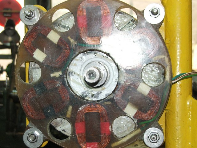

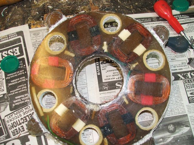

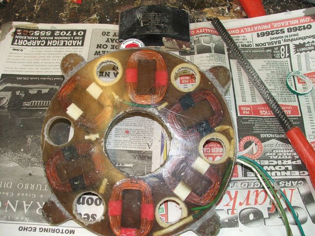

   and now to the holey stator.
   its not to every ones mind to make air holes in the stator.
    but it do sent mean i cant make holes if i want to.
   so i did make holes at the casting stage.
   it worked out well and i saved resin.
     it was my first attempt at doing this holes thing.
  i did think about just drilling them.   but was scared i might cut or brake a
    wire sumwhare.
   this way i could see what was happening all the time.
     i did lay a lot of glass matting around the outside of holes and coils.
     and all the edges for good strength factor.
   another thing i did was to use a bit of plastic laminate on the bottom of the
   mould . you can see its got a wood like finish but was very smooth.
    next one i do i will make the lid from the same stuff.
   in the uk its called formica.  might be called the same thing in the usa.
      just a trade name.
    it wasent so bad getting the bits of bottle tops out.
    so what do you think about holey stator ? good or bad.?
    and now for sum pics

Nice work.
I am not convinced about the holes but apart from a potential source of weakness I can't see them doing any harm. I suspect that by eliminating a filler such as talc or ATH you have lost more thermal transfer than you will gain from the holes but this largely depends on how well you can persuade air to pass through them.
I doubt that any decision could be reached on this without considerable scientific experiment, if holes make you happy then as far as I am concerned they are a good thing.

Nice idea Blue.
Have you tried angling smaller holes so that air flows to the stator as your blade spins?  It could give you a stronger stator and give you better air flow.  Could be a pain manufacturing holes at an angles thru heavy steel plates.

  and now i got sum info on the stator.
   when winding the coils i was looking for a 220rpm cut in.
 testing each coil one at a time ac i was getting 2.5 per coil.
  so six coils were 15 ac. so that looked ok to me.
  but now with the stator finished and running on test bench.
   this is what i am getting out.
        rpm         volts dc.
       260            13.3
       270            14.00
       300            14.7
       320            16.00
       330            16.7
       340            17.00.
   this is with three bridge rectifiers.  one per phase.
   the dc voltage was lower so i had to close up then good working air gap i had.
   now every thing is a bit close .but running free and clear.
    it was in my mind i will need open the gap a bit to lower the cut in speed.
    or the other thing was to put a bit resistance in the dc line.
   now i can see the cut in speed is a bit to high .
   but its working well just going a bit fast.
   this is with a motor on the bench dring the mill.
    but looks like i might lose out a bit in lower winds.
   apart from making a new stater and putting sum extra turns on the coils.
     two in hand 16awg. 52 turns per coil.(should have put 55)
    i suppose that few tuns just makes the difference
       so it looks like i am stuck now with the higher winds
   and wont get much from the lower ones.
     i did connect it to a battery  also used a 21 watt light bulb.
   i was very impressed with the amps out.
    but as it was being pushed with grid power i never took any readings.
  would i save anything if i used just two bridge rectifiers.
    apart from putting a coat of wax on the blades.
   is there anything else i can do to lower the cut in speed.
    blade is six foot dia.
   i thought i had  it right this time. not far out.

No, I think that is good, that is the "tightness" of the NL voltage in relation to RPM... I would be curious about voltage outputs starting from 100 RPM in increments of 50, up to however fast you dare to turn it. Then you would have enough base NL voltage points to put together a nice NL voltage curve. This could be compared to a loaded stator power curve at the same RPM points later on. Those two curves together would be most interesting indeed...

You blow a light bulb due to over voltage not over current because it is the voltage across the light bulb that determines the current through it (assuming enough is available). So, I would just put two 25 or 40 watt bulbs in series.... I.E. with one wire into one and out, then into the other and out, with the second wire on a switch or something... just not in parallel.. this way you will halve the voltage across each bulb and should be OK...

14.7 V at 300 RPM is not so bad.  A few extra turns of wire could have helped.  You could try a boost to harvest at lower winds.  All depends on your blade.
This is what I was thinking:
I didn't explain myself well.  That's what you get when I write late at night.  Holes at an angle which could help air flow to stator.

   yes i did think about other holes and things but i think i will
  have all the airflow i need for the time.
   dosent look like this will stall early  as cut in is a wee bit to high.
     maybe it will be ok.
    vanes built into the rotors will also help move air.
   so that's as far as i am going with air cooling for now.
