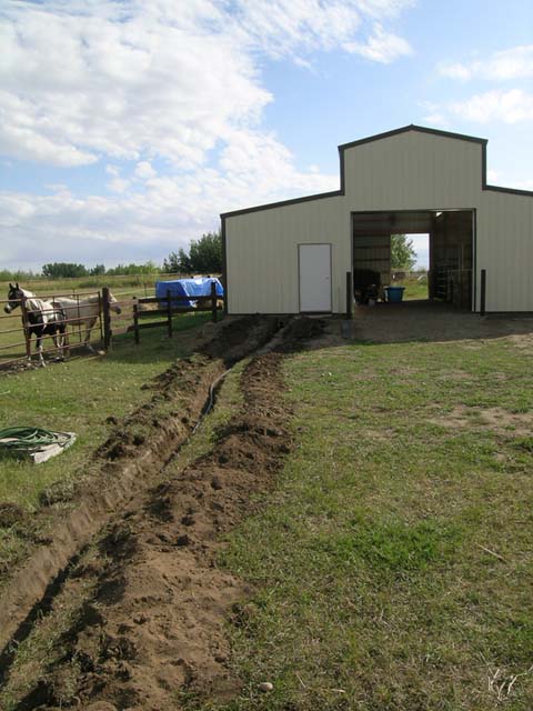

Having located the new barn on the best spot, it was obvious that giving it electrical power from the utility would mean a Lonnnng trench and run of wire.  The utility pole is 300 feet away, and the wire would have to go around the house if it connected to the utility service directly.  The alternative, tying it into the house, would require an electrical modification in the house - where there are no available circuits in the panel.
Well I never intended for my hobby to provide this kind of solution, but frankly it has just paid for itself.  Every penny.  Around Calgary, these days, contractor's rates for digging a 300 ft trench and putting in a 50 Amp service to that barn would run me about 8-10,000 dollars.  I haven't yet spent 6, between the tower, inverter, wiring, and controls.
I buried the wire from my battery shed to the barn on labour day weekend (I think americans call it something else and in the UK they don't even get a bank holiday early in september).  It took me a fair bit of time to sort out the wiring business with the inverter because the cables and amperages are so large.  It's a Xantrex 4024, requiring OO cables and an appropriately sized fuse.

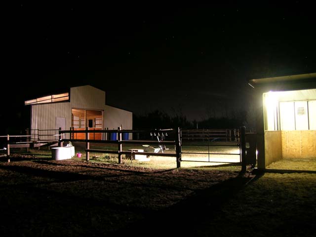

With the wire laid in, and the inverter finally mounted in the shed, I just needed to go to the electrical wholesaler's store and pick up standard boxes, breakers and wire.  Ahh familiar territory.  And here's the result:
As you can see it made a pretty picture.  That's the new barn to the left, with the light on inside.  You can even see the glow in the upper roof windows.  The glare on the right of the picture is a light inside a horse shelter that I put in last year as a "dump load", and it still serves its purpose.  There's also a flood light in the barnyard so my wife can do her chores during the dark winter months.  We're up at latitude 51, and winter days are only 8 hours long in December and January.

Re: Lights on in the Barn (3.00 / 0) (#1)
by DamonHD (d@hd.org) on Wed Sep 24th, 2008 at 12:04:26 AM MST
Good stuff!
(Only 51N? You soft southerner!)

Re: Lights on in the Barn (3.00 / 0) (#3)
by wpowokal on Wed Sep 24th, 2008 at 01:32:33 AM MST
The inner glow from that picture of the lights has to be experienced to be appreciated, well done Steve.
allan down under

Re: Lights on in the Barn (3.00 / 0) (#7)
by richhagen (richhagen (a t) Juno.com) on Wed Sep 24th, 2008 at 10:02:25 PM MST
I didn't think you needed lights at night with the well installers and such about.  Seriously though, it looks great, and for the next few weeks you will probably find yourself wandering out to the barn periodically just to turn on the lights to and marvel at your handiwork.  Rich
