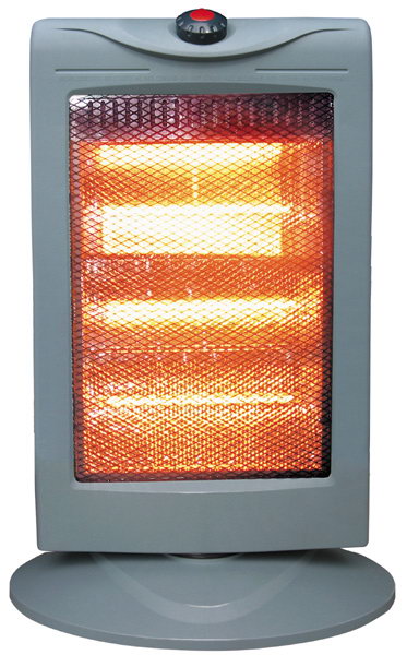

With autumn here in the U.K, I have a real need for free, heating in my office at home (and I also have 440w of solar panels doing nothing in a box, from the REcharge pod project)
Come October, mornings can be very chilly, I am looking at using a few of my eight 55W solar panels to charge a bank of batteries - maybe four 110A/h.
And then using a 1000w inverter to power a mains electric heater, probably an on-demand oscillating heater with a switchable 400, 800 watt settings for maybe a few 20 minute sessions a day..
I have read that all electric heaters have a very high efficiency, up to 100%, which makes sense, or maybe I might be better with a 12v Ceramic type  heater?
Any advice appreciated.
Ben.

A heat-pump of some flavour driven by electricity will typically yield between 2 and 4 times as much heat as plain (wasteful) resistance heating, ie efficiencies of 200% to 400% compared to resistance-heating's 100%.
Electricity is a very high-grade energy source, and wasting it as heat with resistance heating is a shame.

Yes, many people often ask me this: "can I use my PV system to offset my electric heating costs?"
Usually the answer is sure, BUT because PV is so expensive, what you are now accomplishing is taking all the electricity that you just paid a premium for, and using it to waste in an electric heating element, when it could be used for running appliances. My detailed answer to them is there are much more cost efficient and cost effective ways to get heat energy. But IF you didnt pay anything for your PV modules or maybe paid very little, OR you have the PV modules sitting around doing nothing, it might be to your advantage to use it for heat.
Get those things in the sun where they belong!  :-)

So if I built two insulated boxes and put a 100W ceramic heater in one box and a 100W light bulb in the other box, are you saying that the box with the heater in it would get hotter?
Re: Photovoltaic solar for heating a room? (3.00 / 0) (#11)
by DamonHD (d@hd.org) on Sun Sep 28th, 2008 at 01:56:17 PM MST
No, all other things (eg box dimensions and construction) being equal.
But heat is a VERY low grade form of energy, eg 1kWh of heat can typically only make maybe a third of 1kWh of electricity or light and conversely 1kWh of electricity can make and pump considerably more than 1kWh of heat.
So the '100%' efficiency is a bit misleading.
Like I could burn books for heat fairly efficiency for example, maybe 100% in one of those boxes of yours, but that's missing most of their value.
