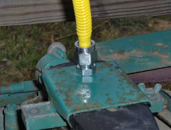

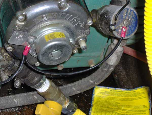

 I have been a lurker here for some time but this is the first time posting. After seeing the onan on otherpower.com and not being able to get carb parts any more, I figured i would attempt to convert my 6.5nh to lpg. I used the lpg components from a toyota fork lift that was getting crushed at the local scrap metal yard. Keep in mind that this is our only generator and we are OFF GRID!! I took some pics and a short video. The video is on youtube. I hope the pics come out ok on the post.
 First is pic of demand regulator and lpg control valve.
Top of mixer.

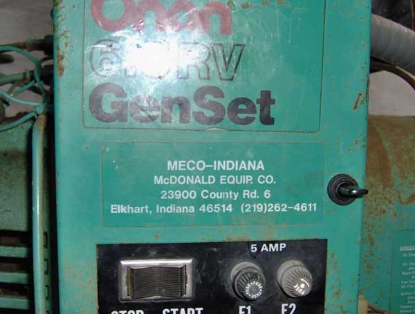

New switch for sellecting lpg or gasoline. Up lpg, center off, down gasoline fuel pump. The carb is still intact with the exception of the choke plate.

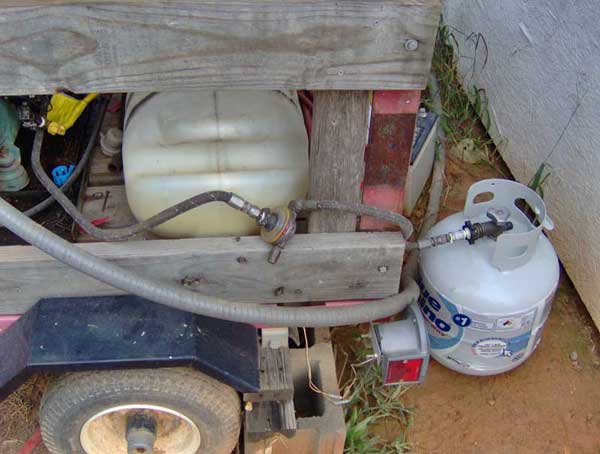

Side shot showing the tank and high press regulator.
The mixer is just a couple of the fittings that came with a kit from lowes for lpg/nat gas appliance flexable pipeing. You know the yellow flexy stuff for the stove. Let me know what you think!

The only potential problem I see is that you've used a BBQ regulator between your tank and the demand regulator.
From my searches on the web that is a bad idea. Can't remember why exactly.
Look at  http://www.propane-generators.com/ I think maybe that's one place I saw it.
Maybe you can just remove the guts (diaphram and spring) if you don't have a hose that will go directly from the tank to the generator.

The first regulator is the one from the forklift. Not sure of the btu but i figured they matched it for the lift so it should handle my little engine just fine. On the same note i did see a bbq regulator at tractor supply that was 100k btu, that should be enought to run a good size genny.

The question I have is if the demand unit is from a fork lift truck, is it a vapouriser. ie ment to be fed with liquid propane and water heated.  If so it has both regulator stages. vapouriser, and first stage to around 100 psi, into the second stage which is a zero biased guvenor, no suction at the outlet, no flow.
Propane has 19,500 BTU per pound, so you can work out your requirement if you can borrow a gas analizer the stoichometric mixture is 14 - 17% and you can regulate the flow to the engine with a screw into the carb fitting.
Look at CAT forlifts they used a US made Beam system with lots of set up data.
Brian.
Re: Onan 6.5nh propane conversion (3.00 / 0) (#7)
by jgnat1488 on Sun Sep 28, 2008 at 05:42:24 AM MST
Yes it is vaporrizor style regulator. It was hooked up to draw liquid. However I did some looking and most can run vapor just fine so long as the demand isnt too high. I run vapor threw out since i am only running at most 20HP, the regulator is rated for 85HP from liquid. It does shut off flow if no vacuum is "felt" kinda like a scuba regulator. The "mixer" sits just above the shaft for the choke and is how it senses vacuum. It only takes a very slight vacuum and it starts flow, too much and it shuts off flow allso. These regulators are really neat in how they work. I was worryied about getting the ratio correct so i installed a ball valve between the regulator and mixer, it turns out that the regulator does a real good job of that. The ball valve is fully open, if slightly closed the engine starts losing rpm. It handles 5000watt load fine so idont think i am too lean. Amount of fuel is controled by amount of vacuum so if the mixer was to be lower in the throat of the carb it should fuel richer, if raised it should lean out. I think i have it pritty close (accidently on purpose) :)

The vapourizer style regulator will have no problems with vapour, the problem could come in the bottle where the liquid becomes a gas, if it can't get enough heat back into the bottle, you will get a frost line round the bottle at the liquid level. Propane boiles at minus 44 C, and expands around 700 volumes.  At around 65C the tank pressure with no take off will be around 150PSI.
The carb adaptor can be a simple pipe entering the air flow anywhere above the narrow part of the choke tube, it is refered to as a spud adaptor, we used to drill through the side of the carb just below the air cleaner clamp.  Some vapourizers have a solenoid on the second stage to give a gas purge to assist in cold starting.  Air cooled engines had a vapourizer that was a concentric pipe that went into the exhaust.
There should be no problems with what you are trying to do and the engine life will be extended, propane is carbon deficient in its combustion so it will clean the engine, if you have trouble starting close the plug down 5 thou propane has a higher ignition temp, if the engine has points not electronic ignition it could eat the points more quickly, it has a slower flame front so there is a longer push on the piston so the bearings should last longer.
