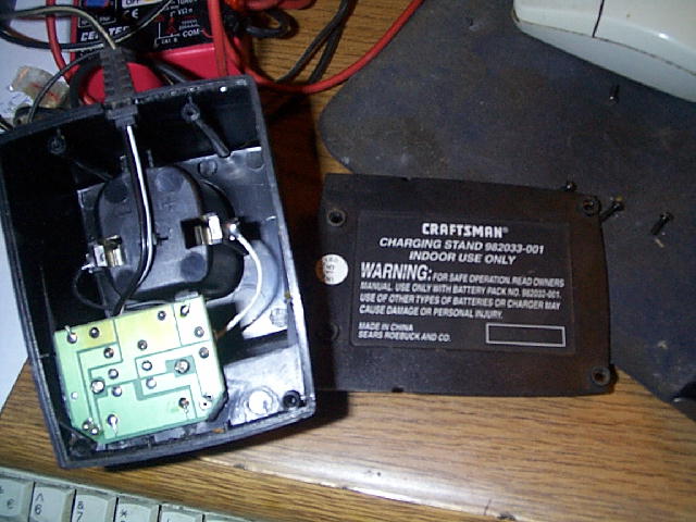

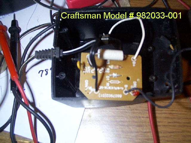

I have 2 craftsman drills, a 13.2 V and a new 19,2 V.  The problem I have these tools allways live a short life for me. I curently use only the 19.2 and it works well, I only charge it when I notice that its not performing well.
My 13.2v drill came with 2 power packs I only got about a year out of them. I didnt use them very much. The charger that come with them is the wall wort type and only does a slow charge.The last few days I got them out to try and figure out whats going on with them, dont know if its the charger or batterys or both. I took 1 battery pack apart, I also took apart the charging cradle and wart.
The problem is that when I place the pac in the cradle the red led charging light does not come on, but a meter connected to the output terminals read .30V.

Here is what I did:
With the Pack still all connected together , I connected to each cell and connected a battery charger set a 10 amps then montary connected the + for about 5 seconds each , after doing this the battery was only alittle warm. I used plexe glass as a sheild, this was all done out in garage on the bench.
I brought the battery pack in and hooked up Craftsman charger that came with the drill, the red led is lite and charging the batterys. This will probly going to be awhile to see what it does.

The batterys have a D on them, 1300mAH, D3,C37,! There's 11 of them per pack. The wort input : ac120 6.6w
     output/puissance : DC20V 200 mA
The instructions say a completly discharged battery will take 3 to 5 hours to be  at full charge.
The battery pack does not have any type of sensor buried in the pack , the charging cradle has a red led indacating when a charge is in progress.
Here is what happens: I placed the pack in the charger (after being zapped with 10 amps 12V for 2 seconds) the red light comes on and charging begins, within 10 minutes the light will go out, I pulled the pack and took a reading and get 8.5 V. Somthing is cloging the works up. These batterys have been sitting for a few years.
really didnt pay much attention to the white stuff, not much of it, Ill wipe it off with a rag.
I have another charger but I dont know much about it. I dont think its for packs this large, maybe 6 or 7 cells,its for remote control car packs. Its kinda neat though, it can operat off dc or ac, and has a discharge feature.

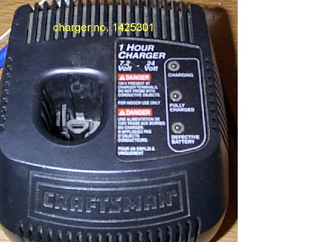

seems to be something like a constant C5 charging. Okay if you're watching it, but once charged it'll just keep charging and eventually cook 'em, you could use a wall timer to keep them from being cooked after say 6 hours.
The charger will drop the 20v down to the battery voltage with a constant current, which is what NiCds like best.
What's the voltage of the other charger? it may be adjustable for these.

The output is 7.2-24v Dc 1.6 Am thats for the fast charger #1425301.

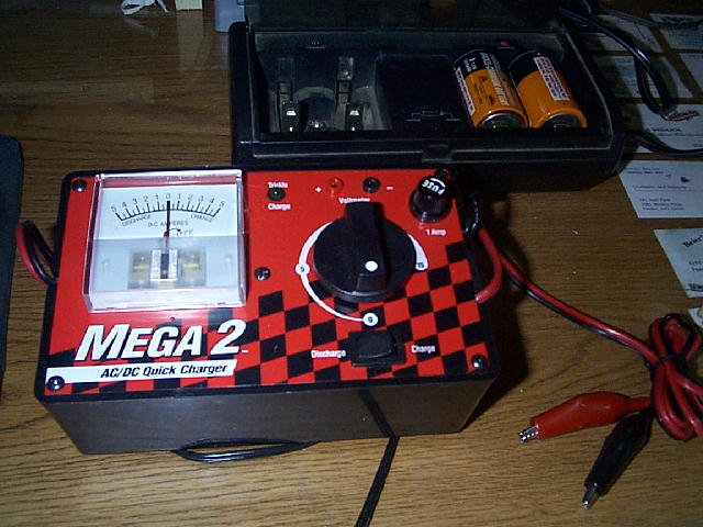

I have another charger a guy  gave me , its trickel charge rate is 100 mAh. (Pictured)
I have been trying to drain the battery pack down with acouple of tail ligh bulbs but ther is afew cells that dont drain past 1.25, I have no problem taking the pack up to 14.5 on a charge, about 5 hours. All the cells read about 1.40 after the charge.
