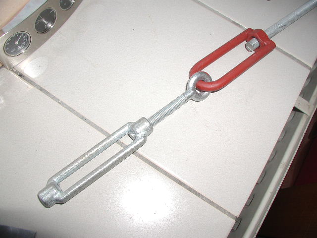

I have four 150kg concrete block's (already cast when i got them) that will be in a hole but will not by under any soil.
Now i want to attach my turnbuckles to them
The red part is something i made to increase tensioning since the turnbuckles alone were not enough during a test raise.

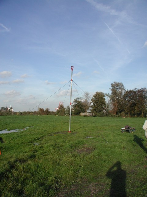

My tower is 20'high and will carry a 6 square feet lenz turbine. In the future I plan to put a 7' diameter "normal" blade on the same tower.

by SparWeb on Thu Jan 22, 2009 at 12:43:01 PM MST
You wrote you did a 'test raise".  Can you tell me more about that, because it sounds like the turnbuckles gave you trouble there.
Using the materials that are easily at hand can be made to work, but when you have the option to do it better and safer, you know which one has got to win.
The concrete block weighs 150kg (350 pounds) and isn't buried.
When you tighten the guy wires, you want about 500 pounds of tension in each of them.
Those blocks will come out of the ground as you try to tighten them.  Load from the windmill is added to that pre-tension, so even if you can tighten it, you've used up all the margin of safety before the wind started to blow.

During the test raise (my first time raising anything) the turn buckles were completely turned in (short).  This was because of not so perfect measurements and I used a rod pounded in to the ground as an anchor, which gave an inch or two. So just to be sure I made the red extensions. The guy radius was around twenty feet during test raise. Don't know the final radius because I have not been appointed a final location, but it wont go under 10 feet.

And for all a picture of the test raise :)
