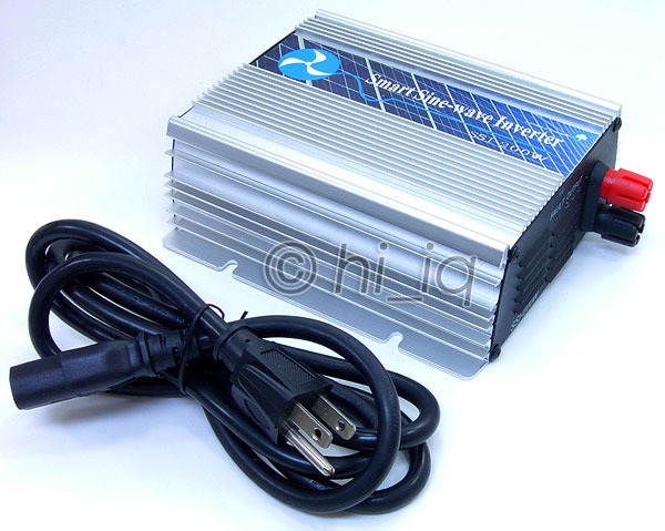

Thanks for the feedback guys! About the inverter... it's a 250watt unit that plugs into a normal outlet, no hard-wiring required. And it's specifically built for a 200 watt solar or wind unit. I know I'm not going to be selling power back to PG&E, but hoping to reduce my usage and get out of that 3rd pricing tier. I actually called PG&E to ask if the inverter was ok to use, and they said yes it's fine. So now I have the inverter and wind turbine in-hand, and want to get it all up and running!
Am I the first person on here to try using this inverter with a wind turbine?

Ok, here's the info on the one I bought, I paid $290 for it on E-Bay, because I wasn't willing to wait and haggle to get it cheaper (around $240). They seem to be selling very well though, and the seller has a very good rating, so I couldn't be the only one.
Here's the info, you tell me, did I pay too much?  Does anyone know for sure that it doesn't work?
Re: Chispito 200 Watt Wind Turbine (3.00 / 0) (#6)
by nathanca on Fri Jan 23, 2009 at 10:38:07 PM MST
Guess that didn't work... ok, here's the pic:

That doesn't look like an OK4U inverter (the one from Holland).
  It does look sort of familiar though.

TLG and a couple other guys are selling them.
One outfit claims "Gov't Approved".  Some may be rated at 200W, but they all look the same.

Read that spec sheet very closely!!
Minimum input---14 - 28 volt
Looks to me like it is not for a 12 volt system.
Hook it to a single 12 volt battery and it will probably
let the magic smoke out.

The specs also say that the inverter is for Solar Panels and never mentions Wind.

Reading through everything again, it does look like I made a mistake on the voltage... the turbine is 12V while the system needs at least 14V. Do'h!
So I can hook up a car battery to the inverter to find out? And if I do need more voltage, what to do? How would one fix this?

Looks like the inverter mentioned is a solar inverter, don't see any way it'd work directly with wind ..

Seems to me that the problem with feeding power back into the grid, via any quick and dirty source -is that the lineman from the power company cuts power and climbs their pole and grabs your backfed power. A bad scene. Prevent this.
Re: Chispito 200 Watt Grid Tie Inverter (3.00 / 0) (#30)
by nathanca on Mon Jan 26, 2009 at 11:05:58 AM MST
Wow, thanks again for all the feedback! I'm still trying to figure it all out, but I'm determined to get something set up, and make improvements from there.
Did some more work this weekend, and I'll take some pics of everything to post soon. I made a few trips to the hardware store, put another coat of primer on the blades, assembled some pipes for the base of the tower, and dug-out the hole for cement. (Turns out that the turbine is on a 1" pipe, which fits into a 1.25" pipe, not 1.5")
I also hooked up the turbine (without blades) to the inverter, and it appears to be working, though it was hard to keep the turbine spinning very fast that way, so I'm not sure. But if this turbine isn't good enough, I'll build or buy a better one, that's part of the fun.
Didn't mention it before, but I do have a good car battery I'm not using, and I could include that in the setup... but would I also need a charge controller of some kind? Are those expensive?
I'm not real worried about the power company at the moment since this is so small, and I acted if good faith to get approval. I doubt they would give As I said the inverter has "island protection" that will turn itself off if the grid goes down, so linemen shouldn't be at any risk.
Re: Chispito 200 Watt Grid Tie Inverter (3.00 / 0) (#31)
by nathanca on Mon Jan 26, 2009 at 11:22:19 AM MST
Sorry, that sentence "I doubt they would give..." was meant to say "I doubt they would give me approval in writing."
Re: Chispito 200 Watt Grid Tie Inverter (3.00 / 0) (#33)
by jonas302 on Mon Jan 26, 2009 at 05:38:49 PM MST
Glad your not getting discouraged get that windmill up and hook it up to your car battery scout around for some more batterys
You can probly use most of your power in 12volt depending what you have for appliances you can run cordless phones,led lighting,tv boxes probly many others you could check wooferhounds files thats how he does his
Hang in there even if that inverter doesn't work out toss it back on ebay get on for 30 buck and plug your tv or something into it
Most of all enjoy your new hobby
