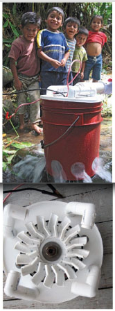

Here is a bucket micro hydro used in Guatemala with a modified car (permanent magnet) alternator.
http://blog.makezine.com/archive/2008/06/bucketborne_hydroelectric.html?CMP=OTC-0D6B48984890
has more details.
He had more head to work with, but it doesn't cost much to make.
