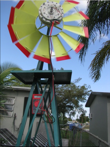

a chance to test a home mill
Yeah, that's an 8 foot Harbor Freight special ($50 with a coupon).

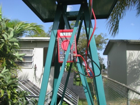

Unfortunately the ceiling fan wires are so thin that it only puts out about 3 watts.
Those are ac volts from one of the two windings.
I get a nice funnel effect from the buildings when the wind is from the east or west.
The picture is taken facing east.

Re: Breezy day in south Florida (3.00 / 0) (#1)
by wooferhound on Sun Mar 01, 2009 at 02:51:25 PM MST
Does that produce power out of the box, or is that your modifications ?
W o o f -={(
Re: Breezy day in south Florida (3.00 / 0) (#2)
by dnix71 on Sun Mar 01, 2009 at 03:09:29 PM MST
My modifications on the fan motor. I just posted in Homebrew Electricity the ceiling fan mod. Hi res pix are in my photobucket account.

Re: Breezy day in south Florida (3.00 / 0) (#6)
by dnix71 on Mon Mar 02, 2009 at 08:40:10 PM MST
It's 30 volts. Unfortunately when I short the wires I only get about .08 amps.
The amps should be better, but I didn't rewire the fan, I just replaced the reluctor ring with magbets. I need to buy and oscilliscope. With 16 magnets and two windings the ac phases and harmonics must be pretty wild. It might be possible to make a circuit to impedance match the output for better power transfer, than just running it through a full wave bridge and a cap.
