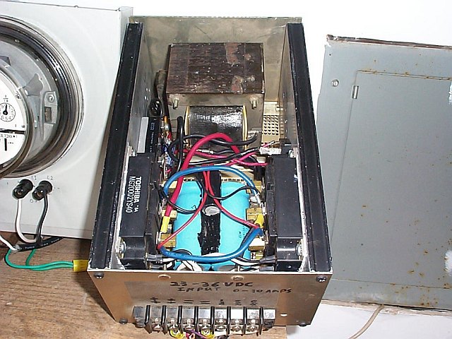

Grid tie inverter schematic
I've searched grid tie inverter schematic for some months.
Everyone talking here, this is thing You can't build at home, You have to buy it.
And suddenly found this:
This is 900W grid tie inverter built at home by tcmtech and using wind power to cut down electric bills.
All story is here:
http://www.electro-tech-online.com/alternative-energy/86777-grid-tie-inverter-schematic-6.html
I think this man is going to change the world.

Re: Homemade grid tie inverter. (3.00 / 1) (#17)
by Opera House on Thu Mar 12, 2009 at 04:21:12 PM MST
Having submitted many products through UL, I can tell you that UL has about as much chance finding a problem as the SEC does of finding a Ponzi scheme.
Re: Homemade grid tie inverter. (2.00 / 1) (#19)
by Ungrounded Lightning Rod on Thu Mar 12, 2009 at 07:15:45 PM MST
The issue isn't actual safety.
The issue is what the utility, insurance company, and code enforcement will allow.
They trust UL.  It's their money, jobs, and employee lives that are at risk, so they get to make the call.
Our opinion of UL's competence may be fodder for graffiti and internet flames.  But it's not germane to the issue.
(That said:  I don't have any gripes of my own about UL's competence.  They may be far from perfect.  But they're SO much better than the available alternatives.  Meanwhile I can always chose to do things BETTER than they require when I think it's necessary and still stay within the regulations.  B-)  )

Re: Homemade grid tie inverter. (3.00 / 0) (#27)
by ghurd on Tue Dec 01, 2009 at 12:15:14 PM MST
It is not up to anybody here to "PROVE that this device can kill a Linesman when the Grid Power is OFF????
You made up your mind it can not, so nothing anyone says will be taken seriously.
How about this?
Grid goes to a brown out condition, then drops.
The IGBTs are latched up.
Transformer starts a fire.
Fire spreads to the neighbors house killing him.
He did not wake up from the fire department sirens because he was up all night working on an unresolved issue that caused the grid to go down because he is a lineman on midnight shift.
"You cannot continue to make claims about the "hazards" of this device without providing any shred of proof of you unfounded accusations."
Actually, as I see it, they have a moral obligation to do exactly that.
I have gone >145MPH on a public road.
It caused no accidents, deaths, injuries, damage, or financial loss.
Therefor I should recommend it as being safe unless YOU want to PROVE it is not?
Of course not.  The concept is asinine.
At least one person in this thread designed items that have the UL Listing.
I doubt anyone will attempt 'a intelligent discussion' with someone making the statements you thrive on.
I'm done.
Ghurd.info

Re: Homemade grid tie inverter. (3.00 / 0) (#30)
by joestue on Tue Dec 01, 2009 at 05:15:25 PM MST
The solution to this is a smart grid. We had the technology back in the 80's using a 600hz carrier for communication.
UL should have no issues building a really cheap (sub $100) box that would shut off your "homebrew" GTI. Will it happen? Not anytime soon.
How about taking a 2000 watt class D* car audio amp and running it through a 2 or 3:1 transformer direct to the grid? I figure an entirely analog sync circuit is possible.
It would be cheaper than his design and still hit 75%. Good enough for me.

I didn't see any grid tie inverter schematic there.  Just a lot of talk and a "partial" H-bridge with no drive and even then, it wouldn't work without about 50 times more circuitry !  OK, maybe only 45 times more parts.
I do see a picture of something that is supposed to be an inverter, (and maybe an IGBT nodule), but I bet that thing just turns off first time the grid goes out...  If it doesn't blow up first !
Does he show a picture of his wind turbine ?  I didn't see that either.  Otherwise, this might be called "Guerrilla Wind".
