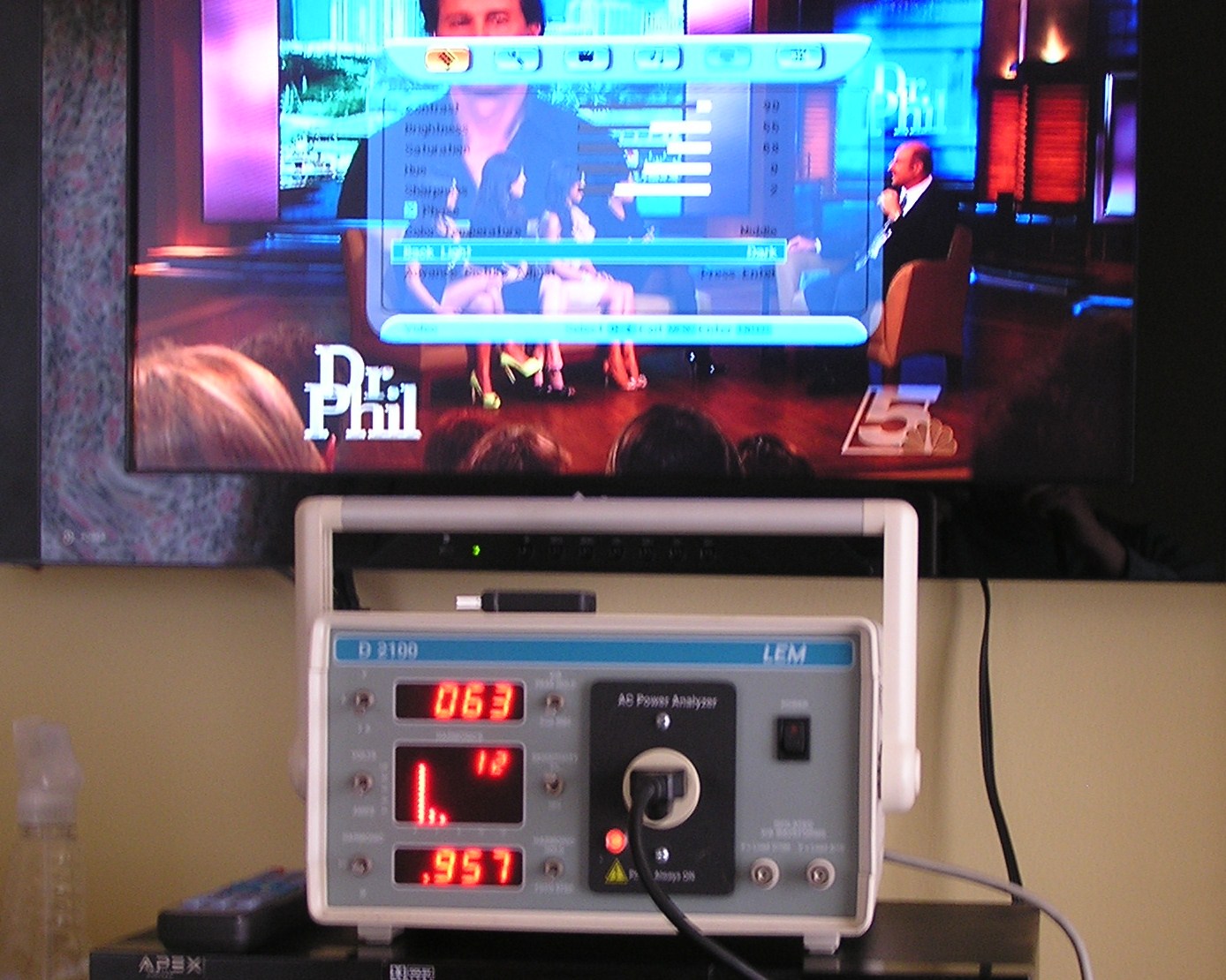

I recently purchased a used 27 inch HDTV which wouldn't turn on.  To verify that there were no other power supply problems, I monitored current with a really nice power meter. Manufacturers tag says 200W, but this TV only draws 132W on bright back light, 112W on middle and down to 62W on dark back light.  Some may not aware that there is an option to control the back light.  This has a really good power supply with power factor control, PF is between 96 and 98%. Surprised at the very low harmonics this introduces on the power line.  62W is not much more than some of my other smaller TVs and more than enough light if you view mostly at night.   Peak turn on current was 6.3A and OFF standby wattage was 4W.  Worth wile turning off with the main power switch.  Hope this is useful in deciding on your next TV purchase.

This TV is an Astar LTV-2701.  You should be able to find a back light control on the same pull up screen as contrast and brightness.   Brightness in a LCD tv has no effect on current, even picture options like cinema,user, normal, or high brightness.  The back light is an actual lamp which provides lighting to the screen.

Hehe, can't help but see the pic of your TV show and think:
Dr. Phil? What a poser.
Not even a real doctor.
