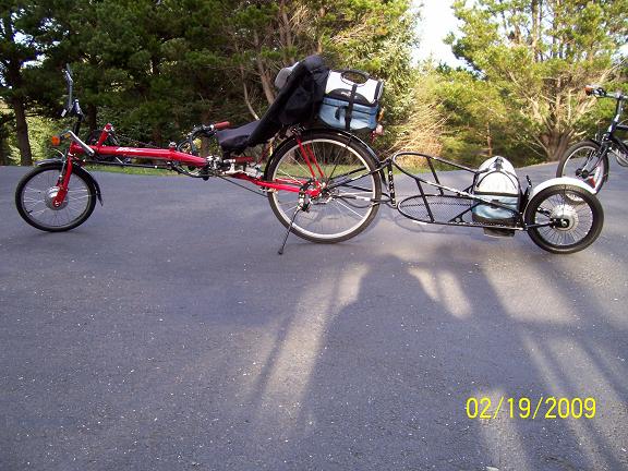

I'm looking for an alternative way to charge my e-bike while riding the wooded trails.  I will be towing a small trailer for camp gear and portable power.
At present I am using (4) 12v 12ah AGM SLA batteries in series for 48v (36-lbs). In the near future I'll be going with NiCd batteries (12-lbs)
A 12v unit would work ok, but I would rather have 48v, thus I could charge it directly with a C-40 (in diversion mode) to limit the load of extras on my trailer!  I only need 150 watts at most.

I'm looking to maybe put a hub motor on a bob trailer and use that wheel as a waterwheel. Just make some strap-on fins that go around the tire, like snow chains.  I'll also have to do some waterproofing of the hub motor.
The wheel on the bob trailer is only 16" and should charge the battery pack easy. If not, I can always re-connect them for 24v (via a switch) during charging process if need be.
Here is someone bike with a bob trailer, so you know what I'm referring to:
Blessings, Snow crow

Knowing how well most "bob" trailers built I'm pretty certain you could have 2 - 3 times the battery cap that I have for our e-bike. Using the "bob" trailer has the batt holder, you could build up sets in full 14.4Vdc packs and attach in a 48V set. I currently use 12ga stranded wire to attach all stacks, and then 10ga going to the controller. Have a look at the exploded battery pic I put up earlier. Its basically the same setup only much smaller amperage size.
Are you planning on using both hub motors? the 1 on the front fork & the 1 on the "bob" trailer?
