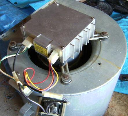

If anyone is scrounging ECMs, this one could get away.  Maybe it should get away (I am undecided at this time).

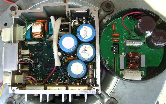

I did not believe it was an ECM by the looks.  A slow spin of the fan showed signs of light cogging.
It has a couple other unusual features in addition to the big square brain can.
The brain is more complex than normal.
Couple big ICs and a few small ICs, 2 fuses, a large bridge, and the under side is half covered in SMD parts.
The round can is the brain style I always found until now.

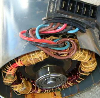

The motor wires go into the side of the motor can instead of the rear end cap.
There are 5 wires entering the motor.
The normal 3 (red, black, and blue) power wires.  And 2 brown wires that went to the brain.
The board traces where the brown wires connect is heavy, like it was intended to carry some current instead of just a signal.
The motor itself does not have the same "individual" windings as my other ECMs.
It looks like regular motor windings.  It will not be as simple to re-configure the coils.  The coil wire is not as heavy.  And they are 2 colors, normal and green.

 From the looks of it, it got wet. It was probably in a vertical application, like a furnace and the a/c condensate drain probably plugged and took it out. The rust in the motor and down the blower housing is usually a good clue. And knowing Lennox's idiot engineers, they probably didn't drill a drain hole in the bottom of the housing to drain it so the water just swirled around until the motor or brains fried. Carrier does the same thing on their package units, except the mount the brains about an inch above the bottom of the unit and when the pan overflows, it takes out the brain. Good for me since I do a 6-1400 dollar repair, but bad for the customer. From the looks of that motor and the capacitor mount strap just above the transformer, I would guess that had some sort of capacitor attached to the two brown wires. Universal blower wiring is usually brown is capacitor(s), red is low, blue is medium, black is high speed. Do the internals have the 18 magnets on the stator and three on the rotor?

"it got wet".  Yup.  Not deep, but wet.  Can see the inside rust puddle in the coil photo.
The brain can is far from water proof.  No signs of moisture.
My recollection is this one works (until I played with it?) and was being saved as a replacement.
Stator looks like a generic motor stator.  Windings do too. Did not look very close, or look for magnets on the stator.
Rotor has the normal ECM looking 3 magnets.
Brown wires go to the internal transforner, big inductor, small brown cap, etc in the top left of the photo.
Seems related to the black, white, and green harness (left side near top). And that black wire went to the external transformer on the blower housing.
Seem mostly isolated from the major power circuits, and has its own fuse.

I'd bet you there's a star connection in that mess of insulation somewhere. Red,blue,and black are probably normal like other ecm's, find the other ends and you're probably in business. If you really screw it up, I have a spare stator from a normal 1hp you can have for shipping. This was the first one I screwed with isolating all the coils seperately and running the 36 wires out of the back of the bearing plate. I would think they would be interchangeable as far as lengths?

Looked like a star connection bundled in the wrapping where I would expect it, but I didn't look all that close.
Did not cut into the wrapping (on "start cleaning the garage day").  Aim was mostly to free up space the blowers take up.

I found the purpose for the Brown Wires.
They go to the thermal overload switch.  That is all they do.
Not sure why the spliced brown wires onto the switch's red wires.  Maybe because the external connector is molded with the wires.
The switch and wires can be cut out.
