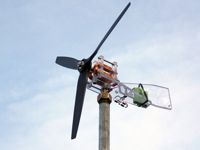

Along similar lines to Wind stuff Eds great work with small radial axis alternators, here is my offering, connected to an off the shelf 3 bladed 12" diameter Radio control plane 'pusher prop' (mounted in reverse).
I realise that this maybe not the best use of the neodymium magnet, but at such a small diameter i did not want to intoduce any magnetic steel anywhere near it (all fixtures are stainless) and obviously no cogging. I'm not quite sure what it would be classed as though, double pole single phase?
It worked very well, spinning at over 1000 rpm easily and charged a 3 AAA NimH pack in around an hour (steady 16 mph wind), it also powered a cluster of 60 white LEDs, power approx 2 watts.
I have put a page up with more detail and video on my site.
http://www.gotwind.org/diy/12-inch-mini-turbine.htm
If nothing else, it was good fun.
Ben.

Was it just the camera or are the LED's flickering in the video?

Andy, yes the LEDs do flicker somewhat, I just used a simple bridge rectifier before the 60 LEDs - no capacitor or current control, electronics not my strong point.
Any help in this area would be great?

Place a fat cap on the bridge outputs.
And a resistor in the pos wire after the cap.
I doubt it will help much... with 60 LEDs!
Each coil has its own bridge?
Will get a bit better output using Schottkys.

Yes the deflection coils would probably work as a 2 phase alternator. The ferrite yoke should drastically increase the output. Ben's design is more like the deflection coils of the era before ferrite that I remember from my TV repairing ventures as a kid.

I don't think it's a bad use of magnets.I even think that with an optimised 2 pole raca design(putting as much wire as close to the rotor as possible) you can catch more flux proportional to the amount of magnet then with most other designs.
An iron'core',housing or iron wire onthe outside of the coils would make a substantial increase of voltage.This should be cilindrical(not square) to avoid cogging,eddycurrent losses are very low for such thing.
What size of magnet did you use,how many turns in the coils?
What non magnetic bearings are in it?Stainless ballbearing,bronze bushing or teflon bushing?
For having a more accurate picture of the alt's performances,you should simply test the open volt output at different rpm's.
