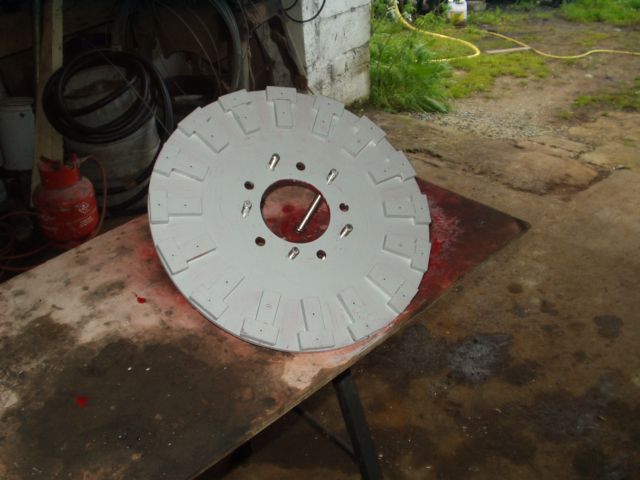

Dual rotors 18 inch by 1/2inch
16 poles per rotor each made up from two magnets T shaped the mags are 2x1x½ n42 with 32 per rotor. Each pair of magnets are like poles forced to sit in repulsion.
The magnets are glued with slow set epoxy and a single 4mm stainless csk screw to secure each one in position (tapped into the rotors). I don't think  I will pot the magnets , I have had problems with rust in the past , I think the polyester holds any moisture that gets in and it just eats into the mags. I have applied several coats of paint over an anti rust primer. Time will tell I suppose!
The bearing and flange are from the front axle of an old series 3 Land rover with new bearings and seals ..
I got a very good deal on the magnets but they were plain and without holes. I had a few spare so I decided to experiment  with drilling them. I know some say you cant drill them while others will say you shouldn't drill them.
So good or bad here is how I did it. I first tried normal hss bits which was useless so I then tried a masonry bit, it did cut but got hot very quick even with coolant. So then I ordered a very cheap set of  glass/ceramic bits from eBay http://cgi.ebay.co.uk/ws/eBayISAPI.dll?ViewItem&ssPageName=STRK:MEWNX:IT&item=200292200863
These are cheap and nasty and I didn't hold out much hope but against the odds they went through them like a hot knife through butter. I cooled the test  piece with water, the bit and the magnet was stone cold though I did go very slowly. The hole(4mm) was cut clean with no chipping or flaking and didn't break out the bottom .
So as the test was such a success I decided to go for it with the set of 64. I set up a jig with in a tray on the vertical drill but instead of water for the coolant I used white spirit , I didn't want to introduce water into the magnet. The jig insured each one was drilled dead centre and the tray held enough coolant to cover the magnets, I also kept a flow of coolant on the bit as I wanted to be sure there was no heat to demagnetize the magnets. The countersinking was done using  the 10mm bit from the same set. The 4mm bit has a very flimsy shaft and  I managed to drill 62 before it bent slightly and I had to buy another set for the remaining 2, such is life lol. I don't have a meter to test the mags but they don't seem to have suffered from the process.
The cuttings  form a magnetic mud and is a bit of a pain to remove, I then cleaned them with surgical spirit and coated the inside of the holes with epoxy.
So there you go that's how I did it, whether it is worth the trouble or if it has harmed them is another matter?

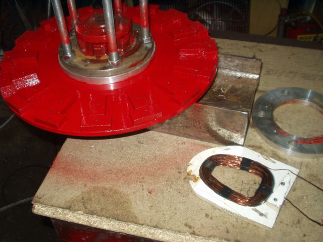

I assembled the rotors and wound a test coil from 1.6mm wire, 80 turns filled the coil size nicely though I could squeeze in a  few more turns if needed, I fitted this coil in a plywood form and inserted it between the rotors. My stator will have 12 coils 1/2inch thick, air gap mag face to mag face is 5/8 allowing 1/16 clearance at each side, I can adjust this later if needed by skimming a little of the aluminium spacers(the nuts in the pic are just temporary) I then spun the rotors and measured the ac volts from the coil. Speed was measured with a digital tacho so should be close. With the rotors spinning at 50 rpm I was getting 5vac (4.93)

You look to be close. I can't easily do any calculations with the T shaped magnets but working on magnet area and rotor diameter you seem reasonable . To me the flux looks higher than I would have expected but you are better off with measured figures than calculated ones.
I would have preferred to do the test at a higher speed especially with a tacho. Voltmeters are not too happy at low speed but at 5v you may be ok. If you could repeat at 100 rpm and get 10v it would be a useful check.
Assuming your figure of 5v is correct then your calculations are correct. For a good wind area 100 rpm is perhaps a little slow for 16ft and if it came out to 120 it may be to your advantage.
I don't think you will stall much, it may be a bit sluggish but if there is any significant line resistance it should be fine. I certainly wouldn't mess with air gaps it's far easier to add an ohm or so in the line.
Sounds like an awful amount of effort but I think it will work out very well. I agree that in your climate polyester potting of magnets is doubtful, I just hope your paint works, it may well be better than polyester, which doesn't stick to the rotors or the magnets.
With 2 in hand 1.6mm you should manage the occasional peak to 3kW. In your wind I wouldn't let it run at 3kW continuous but even so it will not be hard pushed compared to many machines.

   just to let you know I reran the test coil at 100rpm as suggested and can confirm the voltage doubled as expected! I guess its time to wind the coils and finish the metal work. One final question, Would  6% (11.5inch) offset be adequate for a 16ft dia rotor?
