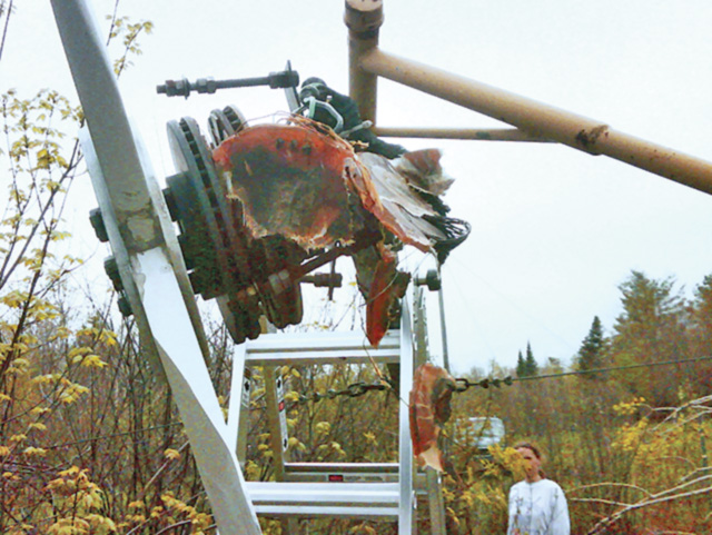

5 Years flying finally fried
Original 1600x1200px photo
After 5 years of trouble free service (for the most part) it fried.
Don't know when or how as it happened over winter when we were not there and it was shorted out during that time. The stator is totally cooked, lost one magnet, prop has some damage but fixable.
Haven't been on the board for a long time and as I'm going to rebuild I thought I'd share this and also get ready to ask questions (this forgettery thing Alzh.. something or other)
Hank

I can't see scuffing on the stator, on this side, at least.  If there isn't any on the other side, then maybe it's more likely a one-time event than a long-time misalignment or deformation.  About all I can say.

I'm not sure what happened, all that I can say is that last summer I put on another prop  and at that time I also noted a bit of rubbing so I realigned the stator. At that time it showed signs of bulging and over heating, non-the less I used it some more especially during hunting season with no problems.
Last month when we went up to our camp we noticed all the wires hanging out so down it came. It was a mess, the stator and coils looked like they were very much over heated. Perhaps we did not short it out as we thought and with some high winds over the winter it fried.
I've already started to rebuild and am almost finished. Fortunately I had a replacement magnet and a stator. The prop just needed some Bondo touch-up and all will be ready to go soon.
Just have to do some recalculations to balance the unit as the new stator is of a different configuration then the old one (fewer windings w/thicker wire)

I can't see scuffing on either side, so maybe it'll be OK?
Might be the first photo to show both sides of a stator at the same time.
Sorry about your machine Hank.  Trying to lighten the mood.
Off-set from the tower to the hub axle?

Wondering about the lightning thing, and how the black is uneven and gooky looking (not paint?).

Prop looks like it is mounted with quite a bit of offset from the hub. Is there any play in the bearings? It could have flexed possibly and rubbed the stator???
I think it would have to be spinning to do this. Is there any rectifier damage?

The off-set it just the thickness of one nut which holds the hub down. Bearing has no play nor is there any flexing of the prop. I still have to check out all the electrical components, rectifiers, wires etc.
We had a severe ice storm here in New England last December with extensive damage to trees. Though quite a few trees were down near the wind mill it did not sustain any damage. I still have to check my wire run from the wind mill to the control center to make sure no fallen trees broke these lines. This weekend I'll check all that out.

wow,,that looks like its had a rough time,it looks like a lightening strike,wires dont necessary have to be burnt out but look for scorch marks at the base of the tower where it swivels,lightening can behave in very strange ways but there is usually some other evidence.

The prop was not all that damaged, mostly just one blade had some dings in it from the stator wire. If it were a runaway situation I would expect much more damage. Also the magnets did not show signs of excessive rubbing as I would have expected in a runaway situation.
One thing I am noticing now that I have a new stator assembled on it is that my expected output is much less then based on the original design. It would appear that my magnets have lost some flux.
Unfortunately I don't have a gauss meter to measure them.
The stator that fried had 9 coils of AWG 16 wire with 80 turns/coil. It's rpm/volt was about 6 in star configuration. Now I have a stator with 9 coils, AWG 14 wire w/50 turns per coil.
I would have expected an output proportionally less in terms of rpm/volt (or higher rpm/volt)but this one is almost 3 times higher rpm/volt at 16.
Go figure! I guess it'll work fine for my needs I just may have to rethink the prop size and configuration.

You say you had it shorted but it started against the short in a high wind. This is always a worry. If a short holds it in most winds you get confident that it will never break away but in this case it did. Once it pulls out of stall it is certain death into a short circuit.
You basically said it was burnt out before, many of these things run more or less burnt out for a long time, most are pushed well beyond normal working temperatures and the life is likely to be short. If you didn't have all phases shorted together then that would have made the chances of it getting away from stall much higher.
There are always dangers associated with short circuit braking. In many cases things survive better if left running if they furl properly. For something that is left unattended some back up way of stopping it makes a lot of sense. If not the alternator must be very large in relation to the blades. In this case it will perform badly without some resistance in the line. This resistance must not be included in the braking circuit. I have often suggested using smaller line cable to improve performance. this is fine with things running and furling but the extra resistance goes against you if you try to hold it braked.

All is speculation as I don't know the cause of failure. When I short it out it's always all phases and it served me well even in winds approaching hurricane force. As I posted earlier I don't think this was a runaway as the damage to the prop was minimal (perhaps lucky) but the stator was totally shattered with wire wrapped around everything.
I have been fighting this furling trial and error thing for some time. On my last servicing of this PMA I lightened up the tail quite a bit to have it furl earlier, which it did.
I'll do some more investigation when I get out to the land this weekend.
I don't know what the life expectancy of these units are but 5 years is not to bad (that's the optimist in me).

I don't think there would be any run away with it shorted out. The thing would cook at quite a low speed, not much above a fast crawl and weaken the resin to the point that the torque would shred the whole thing when it became brittle.
If it was already well cooked and brittle it may have been well on the way and the heat from previous overload may have weakened the magnets to the point where it didn't have the original braking torque. Neos don't have much in hand heat wise and with a heavy stator current producing a demagnetising field and the heat from an overloaded stator they may have weakened.

What I found is that one of my diodes was fried (have resistance measured both ways) This diode only handled one of the phases. The other diode was fine.
There are no open circuits in my feed lines from the PMA to the control panel so the unit was shorted out during the winter when not in use.
Everything else in my control panel is working fine as I also have solar panels and a Chinese diesel DIY back-up generator tied in as well.
I'm basically ready to raise it up again just have to determine my prop size as this will be a weaker PMA due to flux loss in my magnets.
The rest of the story will never be known as I suspect gremlins were at play or perhaps vandals. Last year someone stole 6 of my batteries. Fortunately they were at the end of their lives and not part of my charging/power system.

With five years age I am guessing the stator casting was 'Bondo' polyester resin & the ice storm could've set up some inconvenient movement and ice welded some strands to the rotor (repeatedly?) to get pulled when the blades shed their ice.
When the 3-Phase was shorted, was it at tower base or end-of-line, and what are the tower drop line and transmission line sizes, & where were the wires bridged, before or after the rectifiers? Flux already noted where resistance works against safekeeping via shorting.
