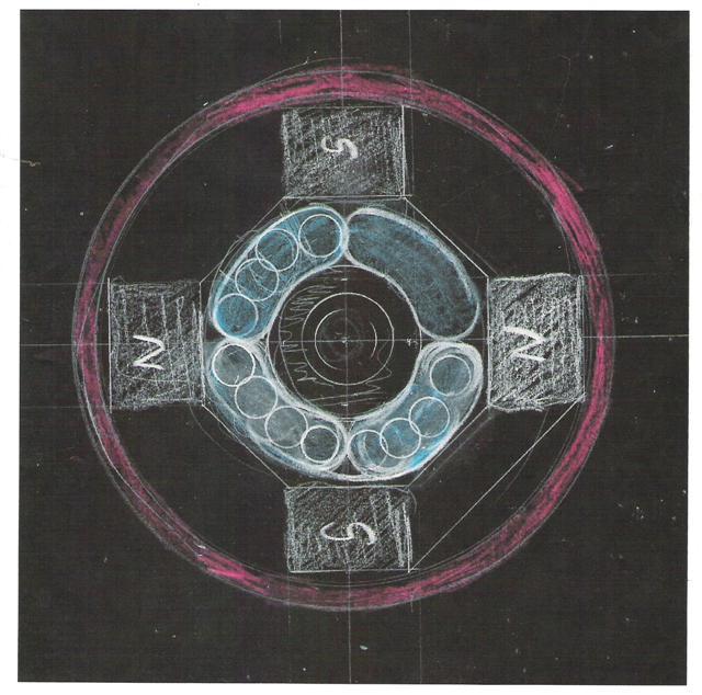

Re: Newbie VAWT (3.00 / 0) (#19)
by electrondady1 on Mon Jun 01, 2009 at 07:30:30 PM MST
i for one am getting sick of computer generated images. here 's a sketch of an idea i had that might relate to your plans. at the time i was thinking about very long coils/poles as a way of minimising the percentage of unproductive end copper .
the coils needed to rest on a tubular stator that retained a bearing and axel
