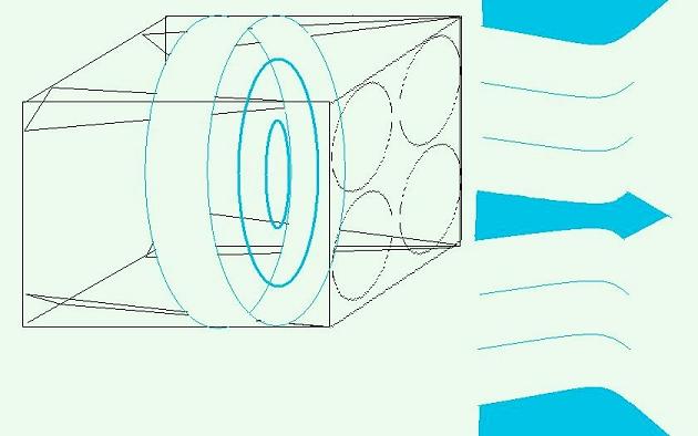

Re: First wind tunnel test. (3.00 / 0) (#12)
by Airstream on Fri Jun 26, 2009 at 07:52:36 AM MST
Wow - 6 x 6 ...
How about using wine-champagne bottle cardboard packing, the interlocking dividers from cases of wine for a mid-tunnel flow vane set? Its precut, stiff, and the local retail stores could come up with enough in a day or three.
A stapler or even a large sewing needle and twine or even small ty-wraps to stitch it together... a bottle of white glue & a $1 gallon of mis-match paint from the local home improvement store to glue and stiffen it up and protect from humidity softening the temper, a razor knife...
If the looks of 15 mismatch box sleeve sets don't 'do' it for you the same thing from refrigerator box cardboard, or even aluminum siding pulled off and on its way to the recycling yard would be a low cost start; you could 'borrow' the trash siding with the promise to return it when you're finished so the contractor isn't out any money and they won't you stomping the siding flat.
If none of the above do it for you - some old fencing and newspaper 'paper-mache' with the above gallon of paint on it would be fairly easy to make a circular & concentric venturi for a mid-tunnel flow equalizer; say an entry cone of 25-30° and exit cone of 5°ish...
The doodle here is just ideas, roufgh detail of venturi on right, etc...
